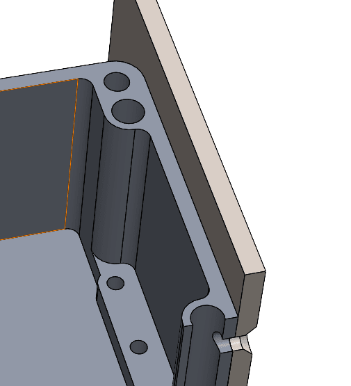

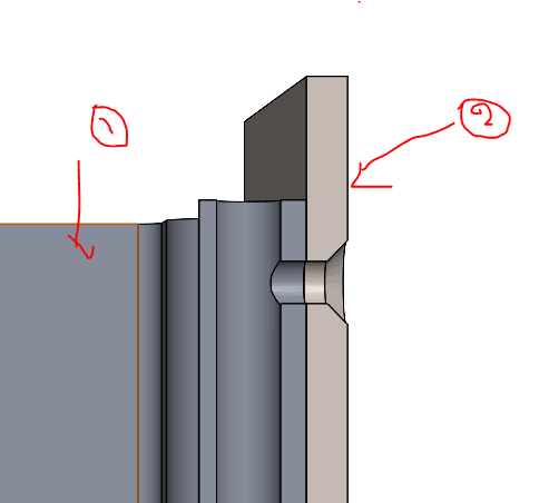

Having a cast Aluminium enclosure with the 3mm wall thickness. now I need to mount this to a mounting plate which fixed in vertical walls. can I have some idea on how should I choose the appropriate fastener?
1. Cast Aluminium enclosure
2. mounting plate, for now, I have placed a 5M countersink bolt
Enclosure can't be changed. this mainly mounts on the railroads it should withstand 20g RMS shock. this is the only way I found to mount the enclosure to the plate since I have to maintain the water-resistance. and have to mount vertically.
Total enclosure weight around 800g
my worry is thread engagement and how can select the way to mount.
Thanks in advance.
I wouldn't tap cast Al. How about a barrel nut ? ... slide down inside the "tube" ... small flange to stop it falling too far.
Or blind rivet (maybe "pop" rivet in your world) ? ... maybe need a small hole on the opposite wall (for the stem, on installation).
You've drawn what looks like a typical Al-Zn diecast enclosure...but without any draft. Are you sure that wall does not have a taper angle relative to the sealing/lid plane?
Agree with rb1957, the die cast material is thin and would likely only engage a couple of threads on the fastener. Drill through the wall and add a nut and washer on the inside wall of the enclosure? Why are you drilling through what looks like a screw boss?
I would find some available space inside the box then poke as many holes as necessary through the wall. A standard bolted joint analysis will dictate the number and size of fasteners, as well as the size (large) of bearing/washer area you need. Water-resistance can be maintained via any number of sealing washers or sealants. The biggest issue as mentioned will likely be casting draft.

I would go for barrel nuts - you will have to just fabricate your own. Thankfully it is not hard to make dozens of them in a "gang" and cut off segments. Also consider a "L" bracket on the bottom (non-lid) side which you can fasten to the superstructure and the bottom face, which is flat and has no draft angle.

This is the best idea.
One barrel nut can even have two or three holes for the other screws.

We routinely drilled and tapped A356 aluminum
castings. The thread depths were 1 to 2 diameters deep.
Must flathead capscews be used? Only one in a bolt pattern will fully seat unless all are match drilled at assembly.
