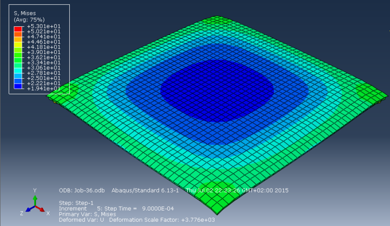

hello every body,
I need to know how to write a subroutine DLOAD I had problems because I'm not used to this kind of work, my problem is how to charge a surface of a workpiece with a set of evenly distributed pressure, each pressure is associated with a ball peening impact and it's must also be moving with a constant speed. In fact, I started to write some thing that totally overwhelmed the surface.
Here is the figure of substrate, on which the pressure is applied:
DLOAD subroutine:
Because of the fact, that I do not have experience in writing subroutines, I want to define pressure with moving:

The problem is, that the pressure affect whole surface, not the coordinates X0, Y0, Z0.
Maybe someone will explain me, please, what should I add to the code?
