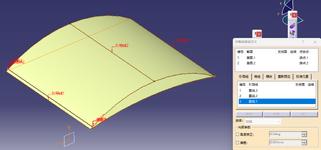

Nov 8, 2024 #1 Galbert99 Student Sep 14, 2023 2 Hi guys, I'm drawing a compressor blade in Catia v5 but multi section doesn't work and I don't understand why. I forward a picture of what I see
Nov 8, 2024 #2 ShataCastings Mechanical Oct 20, 2024 27 Try to use guides instead of coupling Upvote 0 Downvote
Nov 8, 2024 Thread starter #3 Galbert99 Student Sep 14, 2023 2 Thank you for answer. It doesn't work also with guides, it tells me that the extrusion of a vertex of the profile leads to a cusp, I've tried also to change closing points Upvote 0 Downvote
