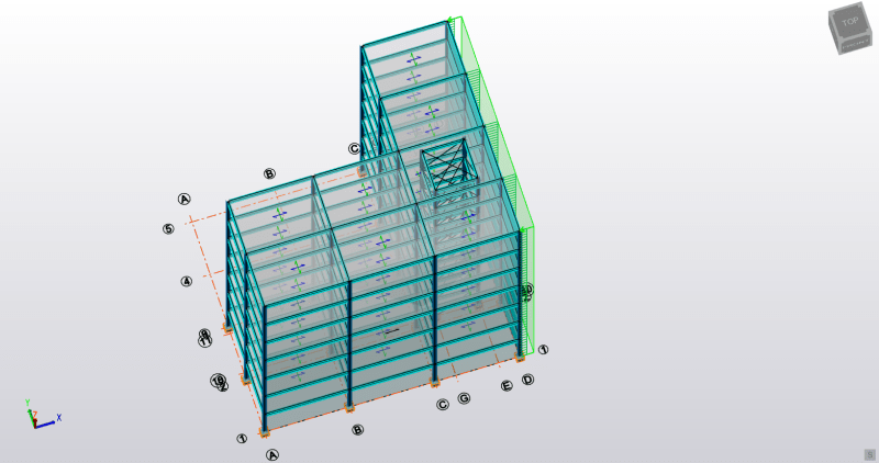

I have been working on a problem in which I would like to calculate the load shares and deflections of structural elements in a multi-storey building. These elements include moment-resisting rigid frames, diagonally braced frames, concrete cores, and shear walls.
Thus far, I have achieved very good approximations for irregularly shaped buildings that contain just moment-resisting rigid frames. However, now I am trying to do the same but with the addition of concrete cores. I need to know the stiffness of the concrete core so that I can include it in my calculations for stiffness of the entire structure?? This is going to be a long post, so if you can answer my question you can stop here. If you are interested in the procedure read on.
Because my building is asymmetric it will experience a torsion and a translation
Here is the building I am working on:
I start with calculating the shear stiffness of each sub frame that makes up the entire structure in the X and Y directions. Look at the following plan of my building:
The X direction is from left to right, the Y direction is from top to bottom, with the wind pressure acting on the structure from right to left.
I hope you can see the frames in the X direction (parallel to the wind load) are made up of 5 frames. Going from bottom to top in the plan we have 3 frames that have 4 columns and 3 beams; then there are 2 more frames that have 2 columns and 1 beam.

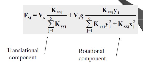

From Zalka he computes the relative stiffness as one divided by the maxiumum deflection for all structural elements. If we consider the formula again:
I am wondering how would we compute the rotational stiffness in the perpendicular direction to the load? Lets say x is the perpendicular direction to the horizontal load, in direction x the load would be zero, so you wouldn't even have any Kxxj stiffness if you used Zalka's method.

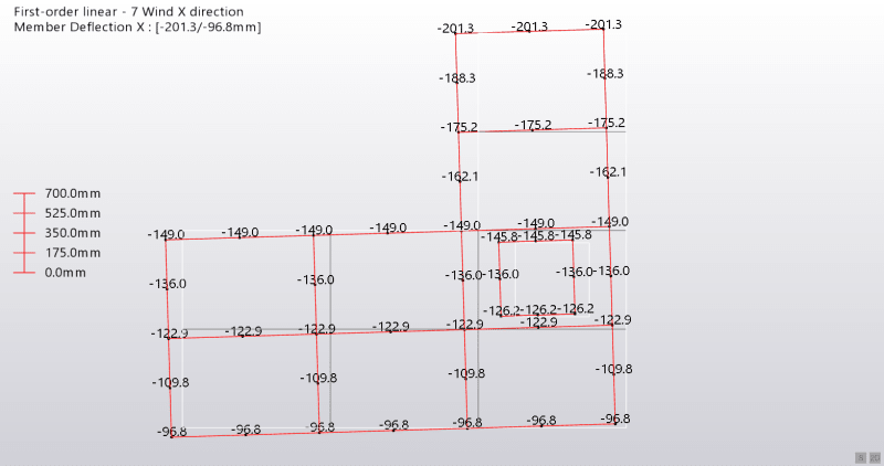

To test the accuracy I compute the maximum deflection under the calculated load shares. When I have the load shares I use the equation delatMax = w*H^2/(2*K).
Where w is the calculated load share, H is the building height, and K is the stiffness of the subframe.
Using the braced core I get the following results in the software:
And the approximate values as:
Code:
     Deflection
               __________
    yframe1      91.805
    yframe2      120.42
    yframe3      149.04
    yframe4      171.59
    yframe5      197.63
As you can see they are quite accurate.

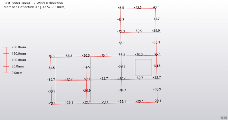

Compare with the concrete core
And the approximate values using the stiffness of the core as (3*E*I)/H^3 + G*A/(1.2*H) are:
Code:
               Deflection
               __________
    yframe1      9.9562
    yframe2       36.31
    yframe3      62.217
    yframe4      88.125
    yframe5      105.23
As you can see they are way off.

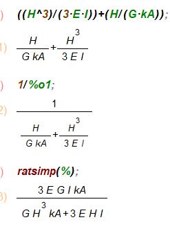

I don't believe your stiffness equation, 3*E*I/H^3 + G*A/(1.2*H), is accurate as the stiffness is not the sum of the inverse of the flexure and shear deflections but the inverse of the total deflection.
Additionally the shear deformation for a fixed-free beam with a point load on the free end is PH/kAG, where kA is the shear area and k is a factor. For a solid rectangle k is approximately 10(1+v)/12+11v where v is poisson's ratio. For a full box section, while not technically correct, I would approximate kA as the two web areas in the direction of the loading.
