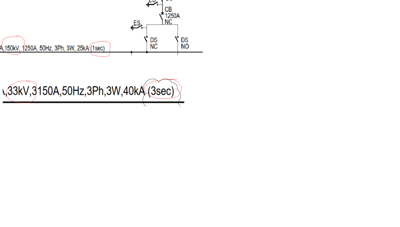

Why do MV Switchgear are rated for short circuit rating 3s?
I have seen (limited to my experience) tripping time in relays is within 1S for faults. Overcurrent it may be more based on current value, but that doesn't a concern to SC rating.
Even if I consider NGR current limiting to much lower value (let's say few hundred amps) system earth fault, in general relays are set to trip within 1s if not instantaneously.
Please excuse my ignorance if I missed any silly point.

Waross, Since it is "SC" rating that has been rated for 3s for mv switchgear, i believe transients are not much of a concern here. So far i have seen for any sc(phase/earth) which is quite a high value 50P is set to trip instantaneously, in some cases earth fault with lower value with some delay but with very minimal delay not even 1s.
I am trying to understand the idea of rating mv switchgear for 3s, where all other switchgears (even HV) are rated for 1s and it is enough. Like you said safety margin could be consideration but again what mv has to do with to specify rating for 3s, where in rest of the cases it has to be defined for 1s.
I am attaching image from SLD for HV and MV example.
Bacon4life, With my limited experience i have not seen backup protection (upstream relay) go beyond 1s trip for sc values. Even power transformers inrush current at mv level is 5-6 cycles. I am attaching one example of relay setting.
I am sure you have seen cases where tripping time going beyond 1s, in case you have any reference document please do share.

There were numerous valuable advice posted regarding rated short-time withstand current 1s or 3s. I only wish to point out other historical reasons which is not mentioned in the posts.
1. In the past, all major standards BS, VDE, IEC, IEEE specified breakers rated short-time withstand current test to 3s..
2. Recent IEC, IEEE... etc do not stated that it Shall be tested to 1s only. It is open up to the manufacturer, 1s or 3s; or even any value between 1-3s. However, test at lower than 1s is also allowed but with limitations etc....,and work out the value based on the similar Tested device.
