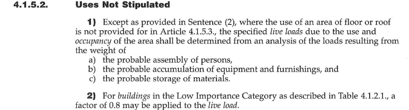

Clause:
4.1.5.2. Uses Not Stipulated
1) Except as provided in Sentence (2),where the use of an area of floor or roof is
not provided for in Article 4.1.5.3.,thespecified live loads due to the use and occupancy
of the area shall be determined from an analysis of the loads resulting from the weight of
a) the probable assembly of persons,
b) the probable accumulation of equipment and furnishings, and
c) the probable storage of materials.
2) For buildings in the Low Importance Category as described in Table 4.1.2.1.,a factor of 0.8 may be applied to the live load.

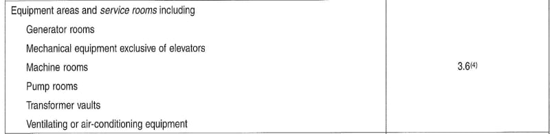

From what I could find,and I've used 75psf (3.6) often
sounds like Pat in the 'peg.
I would say that the spaces dik posted are unoccupied. Since you have 22 work stations, yours is an occupied work space. Since it is occupied, the reviewer probably wants to be conservative unless proven otherwise.
If you don't want to design for the 100 psf, get the actual weight of the conveyors and demonstrate that people (maybe 40 psf on the walkable surface) plus the conveyor DL is more like 75 psf than the 100 psf the reviewer is asking for. It shouldn't be too hard to do.
