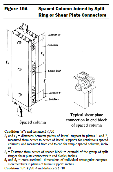

I have a question regarding section 15.3 and 15.4 of the NDS. Refer to figure 15B shown below for bracing of built-up columns (for the purpose of this question I am using 3-2x6 as the built up column and strong/weak axis are orientated respectively). My initial thought when viewing the figure/bracing is that the bracing defined by "L[sub]2[/sub]" would act as sheathing and resist movement along the weak axis of the column, and therefore bracing defined by "L[sub]1[/sub]" would resist movement along the strong axis. This assumption made sense as the weak axis would need a shorter unbraced length. However, reading the Commentary section and section 15.2.3.1, "L[sub]1[/sub] is the distance between lateral supports that provide restraint perpendicular to the wide faces of the individual members" and "L[sub]2[/sub] is the distance between lateral supports that provide restraint in a direction parallel to the wide faces of the individual members". Additionally, in section 15.3.2 (Column Stability Factor), the Kf value for built up columns (assuming 0.6 for nailed plys) is applied only when L[sub]e2[/sub]/d[sub]2[/sub] is used to calculate F[sub]ce[/sub]. This didn't make sense to me as I feel the plys would only separate with flatwise bending/buckling which would be resisted by L[sub]1[/sub]. However, the Kf value is applied for edgewise bending/buckling, where I believe the plys would act together, regardless of fastening. As I see it the Kf factor is applied to the wrong bracing. Finally, when reading section 15.4.1, looking at equation 15.4-4 where f[sub]c[/sub] is defined as less than F[sub]cE1[/sub] and F[sub]cE2[/sub], the ratio of L[sub]e1[/sub]/d[sub]1[/sub] is used to calculate F[sub]cE1[/sub], which is notarized with "for either uniaxial edgewise bending or biaxial bending". Which means the buckling design pressure for edgewise bending is calculated with the slenderness ratio defined by bracing that "provides restraint perpendicular to the wide faces" i.e. restraint for flatwise bending. The calculation of F[sub]cE2[/sub] is the same situation where the slenderness ratio defined by bracing that restrains edgewise bending is used to calculate buckling design value for flatwise bending.
Is the directionality of bracing defined incorrectly for these equations and my initial assumption was correct? Or am I misinterpreting both the column stability factor and buckling design value equations? If the latter is true, please provide an explanation/reasoning for why these values are calculated in this way.

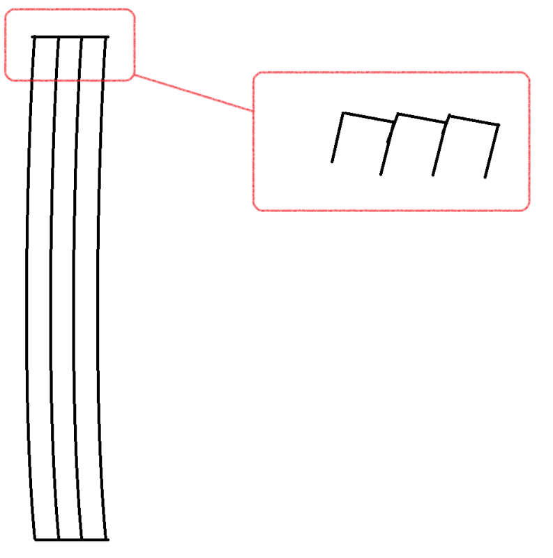

I'd say your interpretation isn't quite correct. I haven't read through the entire post, but the application of the Kf factor of 0.6 for weak axis buckling is due to the phenomenon shown in the image below, where the plies will slide overtop each other when buckling is initiated, and therefore, the member does not act as an equivalently sized single piece. NDS prescribes a 40% reduction in capacity to accommodate the incomplete composite action that develops in this scenario.
The scenario you describe is for flatwise bending/buckling where, as I mentioned in the OP, I agree the plys would separate. However, the Kf factor is applied in edgewise bending/buckling when L2/d2 (resisting bending in the strong axis) is used as the slenderness ratio. Thus, unless I am mistaken, you have arrived at the same conclusion, that Kf is being applied in the wrong direction.
In the cartoon I posted, L2 is bracing interval for bracing in the left-to-right direction, which prevents weak-axis buckling. As your image shows, L2 is not preventing strong axis buckling (there is very little effect for this connection type for strong axis buckling). Strong axis bracing is provided by the L1 designation.
I agree with your analysis. However, The NDS defines the bracing directions as the following in reference to the Figure: "L1 is the distance between lateral supports that provide restraint perpendicular to the wide faces of the individual members" and "L2 is the distance between lateral supports that provide restraint in a direction parallel to the wide faces of the individual members" and additionally states Kf is to be applied when L2/d2 is used as the slenderness ratio.
Yep, that's what 15.2.3.2 states verbatim, however, section 15.2 is for spaced columns, section 15.3 is for built-up columns. If you look at Figure 15A, you'll see that L2 is switched in direction for spaced columns.
Here is what I see in the definitions section, which hopefully adds a bit of clarity to the reference plane.

I see... I was applying the Figure 15A definitions to Figure 15B. Thank you for that clarification.
