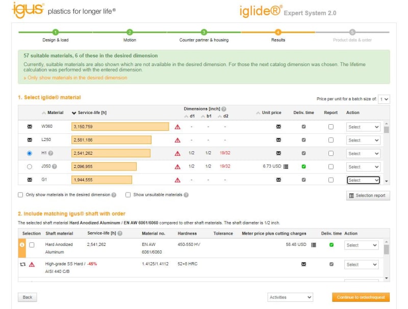

This opens a new question about below what load and rotation conditions would a self lube sleeve give good service life as well as what level of more intense conditions would require capitalizing up to ball bearings for good long life design.
It’s clear I need to research sleeve/bushing design and search out their better vendors.

I had been checking out the IGUS site and came across their bushing service life calculator.
Fast/Easy. My first test run sold me on their company.
So much better than a pic and price.
B

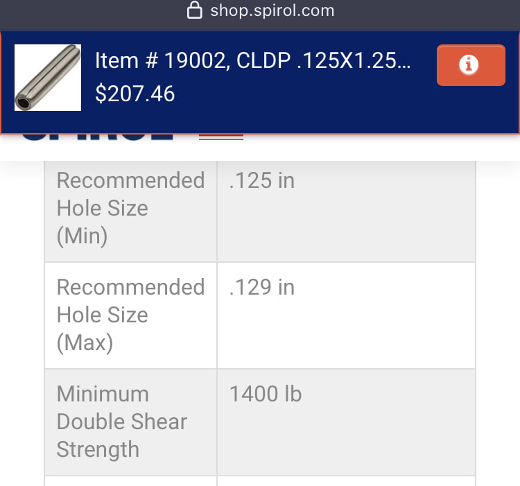

A little study on spring rolls pins was enlightening.
The Spirol 19002 Standard duty, chrome stainless, 1/8” x 1.25” is good for 1400# in double shear at around 20 cents each (1000) … which is easily 3-4X this load.
A smaller hole allows more 6061 meat in the links. A plus.
However, with the roll pin’s edge inside the inner, bushed link, it seems that using a plastic (IGUS) bushing creates the chance of the pin’s edge digging into the plastic, which could create a binding problem?
Possibly moving to a bronze bearing to encompass the hardened stainless roll pin would be a better choice to be pressed into the middle link hole in the aluminum link?
Thoughts?
