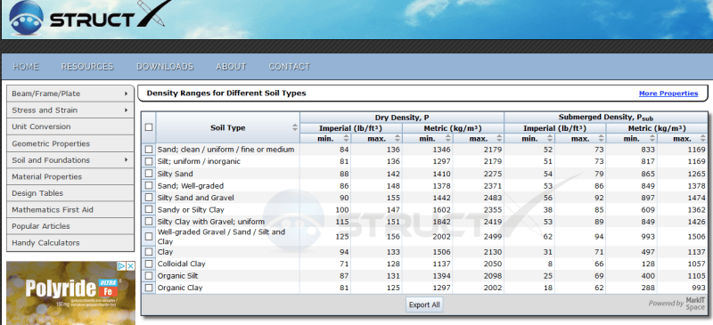

oldestguy said:
That estimate of soil loading is way off, more like 150 pcf.
Well, I suppose it can vary a little depending on the type of soil, but I usually consider it to be somewhere in the order of 100 or 110 pcf. Taking water at 62.5 pcf, the maximum value in the chart below is 1.6*62.5 = 100 pcf. It may be a good idea to bump that up a bit to account for the possibility of it being wet. The eor will make that determination for himself when he performs the design as well as offering a little advice about the type of equipment to permit on the roof. Might be a good idea to fence the property to prevent armored tanks and heavy trucks from driving over the roof.
A live load of 100 psf should take snow loads into account but again, it would be the job of the EOR to make that determination.

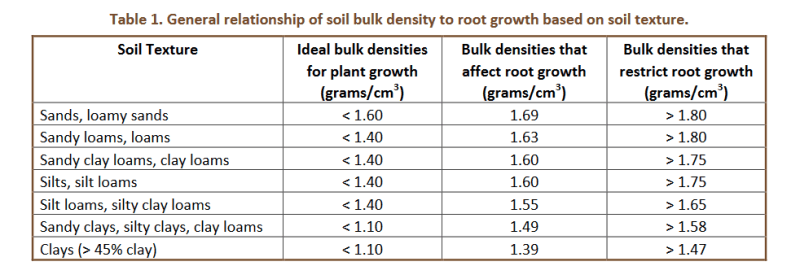

Here's another chart of soil weights. If lawn is planned over the roof, I would expect a loam to be used. If you plan to grow giant redwoods, you might want to give their future weight some careful consideration.
BA
