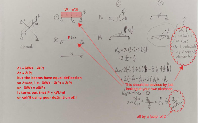

Hi, first time posting here so I hope i don't break any rules and post in correct section. I have an exam soon and my prof failed to provide me with any sense-making answer (he constantly makes mistake when writing on the whiteboard meaning most of my notes are useless). I have an issue with understanding how to use force method when I add another dimension. On attached pic you can see 2 beams that are placed on eachother but without any welding. When calculating the missing force x1 do I treat it as if it was just another support for the beam called (1.) or do I need to also include the other beam (2.) into the equation?

ok ... lets call the loaded beam "beam1" and the supporting beam "beam2".
In the typical problem the "crossing point" (where beam2 supports beam1) would be a fixed point, so your problem solution would be ...
a)remove the redundant support, and solve the beam1 statically, determining the deflection at the redundant point, D
b)solve beam1 for the unit load, calculating the unit deflection at the redundant point, d.
c)determine the redundant load, so that there is zero deflection at the redundant point = D/d (the equation here is (D/d)*d-D = 0 ... clear as mud?)
In this case there is some deflection at the redundant point, so
a) solve beam1 (without beam2) statically, determine the deflection at the redundant point, D.
b) apply a unit load to beam1, determine the deflection at the redundant point, d1.
c) apply a unit load to beam2, determine the deflection at the redundant point, d2 (in this case = d1).
d) then the deflection of beam 1 = deflection of beam 2 ... D-X*d1 = X*d2 ... X = D/(d1+d2)

I don't know how to reply here so I'll just write like this. Sorry about Sh*ting on my prof, I just got frustrated for not being able to comprehend this normal way but thanks to both of your explanations I think I'm getting a hang of it! As for notations, these are specific for my country I suppose and may differ for you, that's why I decided to write here cuz I had no idea how to even look for an answer for that myself. Now I can pracitce it further with newly gained knowledge. Thanks again, you two were great help and I hope you have a great day
