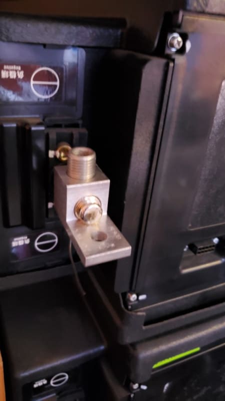

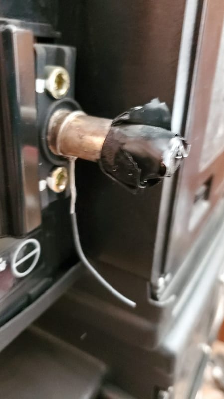

I have to connect sixteen 2AWG cables probably with lugs with 5/16" or 3/8" holes unless someone has a lugless solution.
These batteries have odd terminals that are 0.560" in diameter and about 2" long.
I need a 200Amp connection between the cable and the battery terminal.
Some sort of split tube?
Some sort of split bars with a a trench in their faces?
Slit block with a hole thru the center?

You would need to maintain equivalent cross sectional area, so I could imagine some sort of vertical busbar that terminates into a vertically extended conventional battery terminal clamp.
It would need to be mechanically supported, since 16 2AWG cables would put a lot of torque on the battery terminals.

I've decided to go with a standard 8AWG-250MCM mechanical lug used backwards bolting the cables with standard swaged lugs to the mechanical lug. The hole the setscew normally clamps to the cable will be what I clamp to the battery terminals.
