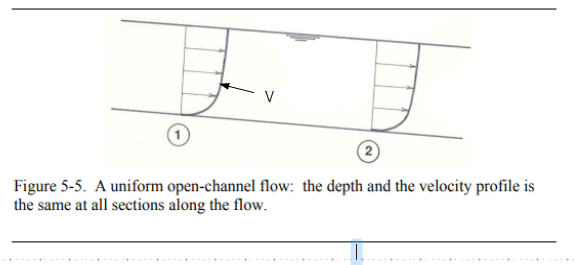

Hi. For environmental purposes, we need to calculate the minimal water/ice SPEED needed from the river to be able to move this large boulder laying on top of the rocky riverbed. The river is in Canada and fed by rainwater only. This is a non-profit project. Please advise on a formula to use.
It is a white water river during a few months a year, no vegetation only bare rocks, a very rough surface. Below data has been calculated with a photometric 3D scan of the boulder and 3D software. The boulder is pointy at the edge facing the waterflow:
Boulder weight:
17.47 metric tons.
Boulder footprint (area touching the riverbed):
6.4 square meters.
Boulder upstream surface in the direction of the water flow, exposed to the push of water and ice. This is the flat 2D surface. The real surface is larger but angled as its the pointy edge of the boulder that faces the riverflow:
2.9 square meters.
 https://files.engineering.com/getfile.aspx?folder=1978b187-8052-47aa-b6bd-45f7e069d0bd&file=IMG_3127.jpg
This is a profile of open channel flow. The velocity at the bottom is impacted by the roughness of the flow bed, that drags the flow.
