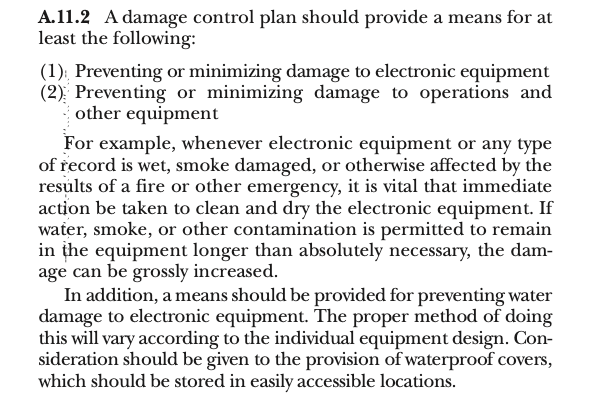

The NEC has requirements for electrical installations in normally "Damp" or "Wet" locations.
I'm trying to find out if NFPA 13 would require a space, that's normally not considered Damp or Wet (i.e. indoor) to use Weatherproof enclosures.
The system being installed is a watermist system per NPA 750 and I haven't found and requirement in either NFPA 13 or 750 other than signs needing to be weatherpoof.

Haven't ever seen or heard of such a requirement for the equipment to be designed water resistant (have been in fire protection engineering since 1970s). There is an exception in NFPA 13-2013 section 22.31 "National electrical Code" for dedicated electrical spaces to allow sprinkler piping "provided protection is installed to avoid damage to the electrical equipment from condensation, leaks, or breaks in such foreign systems." (referencing NEC 70:110.26(E)(1). The non-mandatory Appendix A.22.31.2.3 says "... but a shield needs to be installed in this case to protect the electrical equipment from potential leakage." Note the "dedicated electrical space" is a specific volume above the equipment, not the entire room.
A relevant item from NFPA 75 "Information technology Equipment" Appendix recommends emergency planning to include portable covers:
Outside of NFPA Codes, ABS MODU (Mobile Offshore Drilling Units) Rules require "evidence of suitability for use" of electrical or electronic equipment enclosures with protection lower than IP44 in areas affected by sprinklers or water mist systems.
