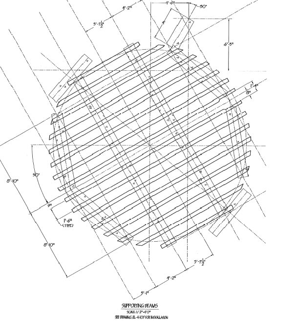

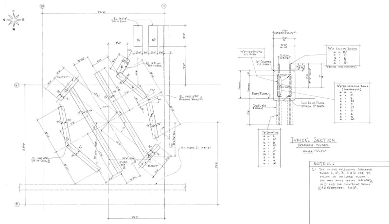

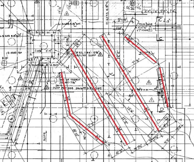

I forgot to precise that we are actually replacing the old tank by a new one with almost the same specifications, so there will be no significant load change. The old tank was supported on steel beams wich are supported on concrete beams as shown in the following drawings. I don't know why they chose this complicated design, especially the concrete beams are sloped and there is no pipes to pass through them.

1) The floor slopes about 3.7% (about 10" fall over approximately 22'6" horizontal). This is very steep, we typically used 2% floor slope in critical areas of our electric generating stations. They wanted positive floor drainage underneath the tank to the trench; this can be quite important for some industrial applications.
2) Check with your Client to see if loss of under-tank drainage is important. If not, put in the dowels as others have suggested. If seismic loading is required, dowel details become more important.
The steel grillage is sometimes used to allow access to the bottom, usually for leak detection. And used for some elevated tanks in the olden days.
On the design shown, it looks like they were trying to transfer loads to specific locations/piles rather than to the slab. Maybe they deduced or assumed the slab was inadequate for that purpose?

The slab should be more than enough to support the tank. As per shown below the load is not transfered directly to the piles. I think it's most probably used for leak detection and drainage below the tank.
