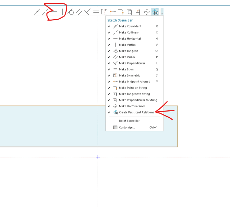

Good morning,
We're having a bit of trouble with how sketch constraints work.
How can we only have persistent constraints? Example when we create a rectangle by default the verticality and horizontality constraints are not persistent
Thank you and good day

If you go to the "scene bar" at the top of your screen, there is an arrow on the right, click this arrow, at the bottom, there are "persistent constraints". Then you get the horizontal and vertical persistent constraints like you want.
