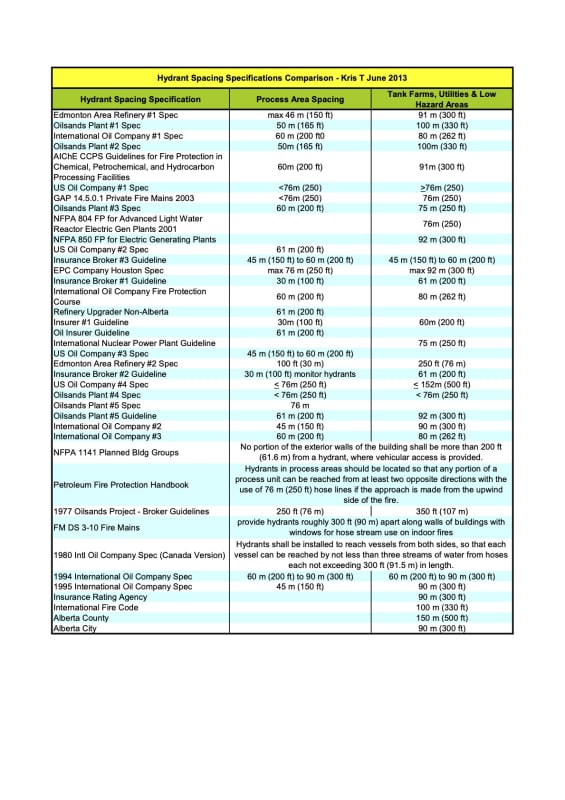

My question is that, if i want design Fire Hydrant and monitor System form a plant ( Chemical or Else) which NFPA Code i have to use?
i studied NFPA 1, 14, 24 and 291 But non of them are not as AS 2419,
For example: how i could Counting Number of hydrant for a plant accordance to NFPA or What is the a Hydrant Required Pressure and flow rate? in AS2419 For a Hydrant valve, We should provide
10Lit/Sec with 700 kPa but i can't find any thing in NFPA.
i attached a picture as sample design in AS
so many thanks for you Guidance
For industrial, chemical, petrochemical plants NFPA is usually the minimum, with recommended good practice also being the relevant FM or GAP / AXA guidelines, e.g. FM DS 7-14 Fire Protection for Chemical Plants, FM DS 3-10 Private Fire Service Mains, GAP.17.2.1 High Hazard Chemical and Petrochemical Plants, GAP 17.3.1 Refineries and Large Gasoline Plants, and GAP 14 Private Fire Mains, among others....
