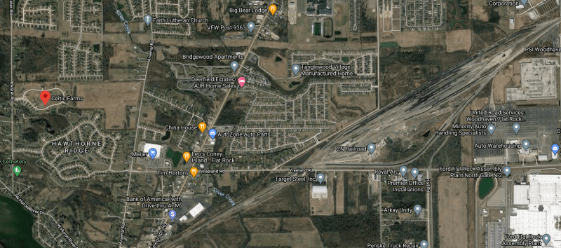

Which way to the factory and the machinery?
Did you forget to mention the railroad and the rather large marshalling yards?? About 1 1/2 miles away.
And a whole bunch of level crossings.

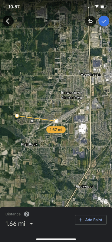

Flat Rock Metal Factory location and distance from my home attached.
Hi Littleinch. Thanks for the response. Yea there is a train yard 1.6 miles away. I have been down this route and have been in communications with the company as well. I have driven there at all hours of the night. I do not hear or feel the same noise as I did at Flat Rock Metal. I can identify the sound of the train moving along tracks separate from this sound. At one point I read an article regarding trains and the fact that they must stay idling during the winter months because of the engines. What I am experiencing is present all seasons. It goes on for days and days and then stops lidyerlay as if someone flipped a switch. It’s constant during those times without a break.

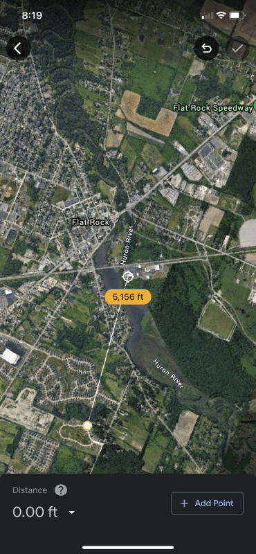

Edit: Note the Huron River with water that is a darn good conductor of vibrations.
I was just thinking the same thing about the river channel. There is a dam there too. Might the vibrations correspond to flow cascading over the dam. It would also be a low frequency source. Channel is also to SW. Otherwise I've got nothing.
