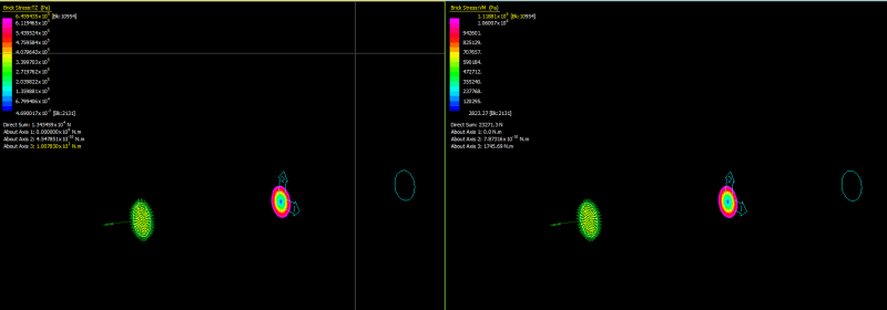

Example (D=0.2 m, L= 2 m, Torque=1000 Nm, Steel, fixed on one end)
Theory: 6.37E5 Pa, and as can be seen from the left image below the TZ ("torque shear") is 6.46E5 Pa which is very close (sum om internal forces there give the exact applied moment also ~ 1007 Nm) so it is all good.
Finally VM (right image) is as expected about sqrt(3)*shear torque value, thus 1.12E6 Pa.

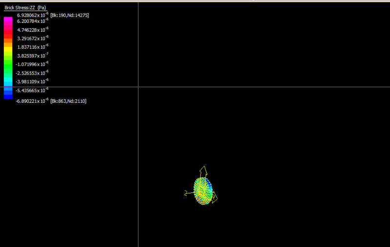

Now there might be some axial stress due to the applied loads and restraints (local effects though), but at the centre length (along shaft), the axial stresses should be almost zero in this case, since any local effects do not influence that area as it is locate 1 m away from restraints and applied moment.
Below is a slice of elements just at the the centre of the shaft, and as can be seen the axial stress (along global Z axis) is almost zero.
