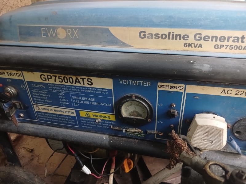

Normally, our fridge works. We live in a rural area where there are power interruptions. We have to use a generator sometimes for several hours. When the genset is proving power the fridge (rated 230 V - 2.7 A) will not start. But ... if we plug in the electric kettle (2000 W) in the adjacent socket, presto, the fridge miraculously comes on . I tried this in the other 3 dual sockets in the kitchen and like the first socket, the fridge wouldn't start until I glipped the 'on' switch of the kettle. With each of these tests, the fridge would stop running a few seconds after the kettle stopped boiling. The house is old and for an immediate fix, where would you expect the problem to be?

But the issue would seem to be your fridge is sensitive to voltage or frequency and your generator needs a load to stabilise it.
Do you have a heater you can connect?
But first start looking at the voltages supplied before and after the kettle is turned on and off.
That generator looks rather old and I suspect its control of voltage is now rather poor.

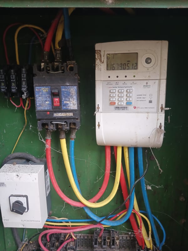

I hope you have a procedure where you disconnect the incomer before turning the generator switch on. The selector on the white box selects the power source. To be frank that connection is very dangerous and with only one connection for a 6KVA generator is dangerous. I agree its very dangerous. I am a tenant and not the owner.

That generator looks rather old and I suspect its control of voltage is now rather poor. The voltmeter needle did not seem to vary from about 230 V today. But from my calcs the genset is certainly undersized for the demands at the two houses, and it has never started the aircon.

Further to David's suggestion; those small generators tend to drop both voltage and frequency when a load is applied.

Let's go back to basics here looking at your incomer cabinet.
Do you have three phase power coming in?
What are the three incoming wires?
How is this connected to give you single phase supply?

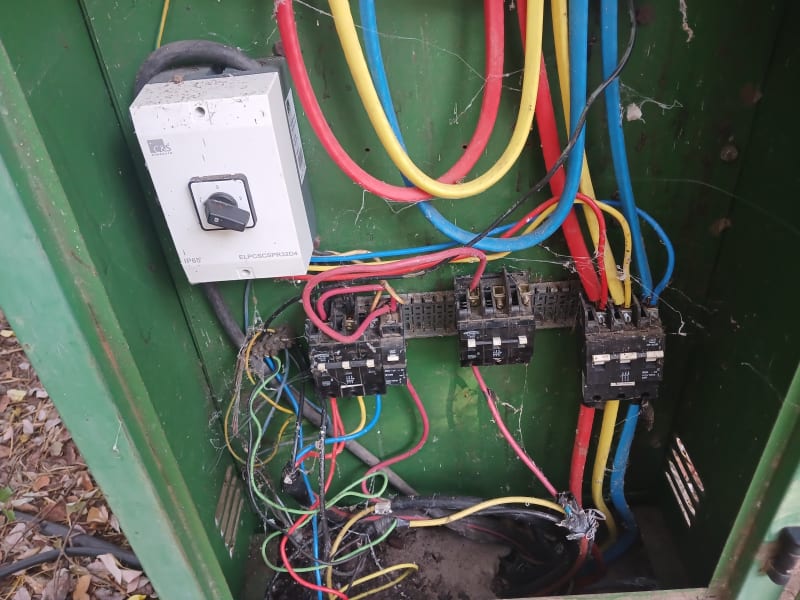

How is the generator connected to the house wiring?
What happens when the power goes off? What switches do you connect?
What is the white box and positions mean?
Connecting a single phase generator into something designed for three phase is going to give you weird results.

The whole thing looks very dodgy to me....
Ask him for a wiring diagram and see what face he pulls.
