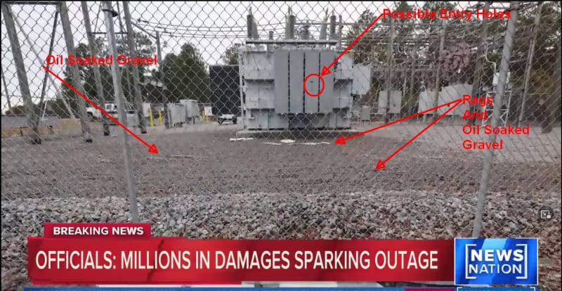

Video from a local news report may confirm transformer radiators were shot at-

the Sheriff commented the vandel "knew what he was doing". that could mean that it was not a missed shoot at a deer, but intentionally aimed at transformer.
Now that the utility can not reroute service to that area through a different feeder, Did the attacker know the grid and those TWO substations would indeed isolate the area?
the "State of Emergency" for the area IS much worse than one might think.
If only the radiators (or oil circulation) they might be able to repair, where as ex Fed speculation is bullet struck windings (unrepairable, or very extensive)
From the outside your suggestion is not so wilf arsed.
Inside job and knew where to aim.

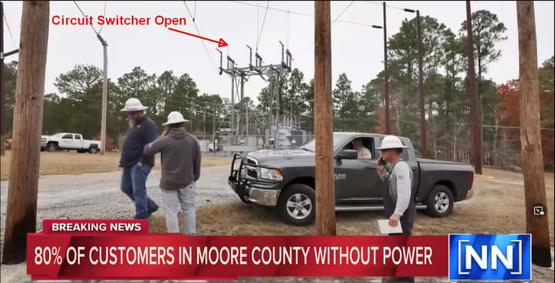

One of the substations mentioned is called "West End 230kV Substation 6910 NC Hwy 211".
Which can be found here on Google maps:
Viewing Google earth it appears this station has three 230kV incoming lines, two 230/115kV auto-transformers and three outgoing 115kV lines- one which radially feeds a distribution substation near the intersection of 211 and 1210; with the other two forming a loop around Moore County supplying 6 distribution substations. No external interconnection appears within this 115kV loop.
Assuming vandals damaged both 230/115kV auto-transformers at West End substations the entire 115kV system within Moore County became de-energized. Further it appears vandals also damaged 115kV/24.9kv(???) transformers within distribution substations.
Whom ever did this had intimate knowledge (of the system) whilst making a lasting statement.
