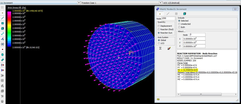

This is very straightforward - as you can see below in Strand7 (software I work for and develop together with our team in AUS), an example of a CSS with a radius of 0.1 m, length of 0.1 m, and with steel say yielding at 200 MPa, gives a yielding force (axial) of 6.28319E+06 N.
As seen below the total axial reaction (using displacement control, thus enforced displacements on one face, pink arrows in the image), is exactly that and the whole section has yielded at this load with 200 MPa all over the section at yield. Now all general purpose NL FEA packages can predict this using HEX8 or HEX20 elements (no need for reduced integration) in pure axial loading so very easy.

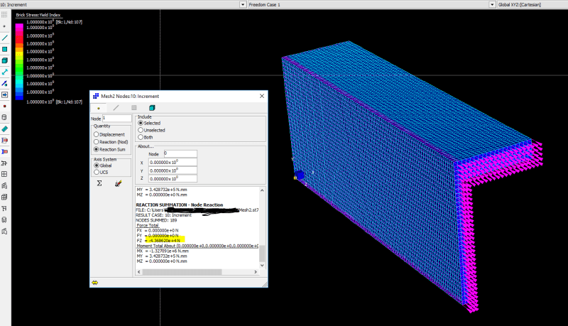

Here are the results for the not common cross section you have (correct as it should be and equal to as shown below see total reaction of 44000*4 N (1/4 sym. so times 4).
So the boundary condition to use (skip and RBE2 or RBE3 constraints) are (1/4 symmetry): bottom face at mid web height in the image use Y displ. = 0, for the large face at the symmetry of the web fix X=0, and finally the two ends (z= 0 and 100 mm) use on one enforced displacement of Z=-0.15 mm, and Z=0 mm on the other. At the common edges for these faces it is important that the BC are added (not sure exactly what abaqus does), I enforce this since I am applying BC straight on the mesh nodes in Strand7 so I know what the solver sees, and so I know what I am doing exactly. So just follow these steps and it should be fine (mesh is all conencted so not using any tie-like constraints, evenhough that should not cause any problems, and not using RBE2 and RBE3 constraints, just simple/standard BC as explained above).
