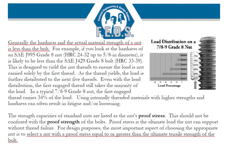

hello guys,
Am I the only one that seeing a contradiction here (I highlighted the contradicting sentences)?

I think they speak about material stresses.
What you said about High UTS Stress and low Yield stress sounds reasonable as long as we take in account that the nut thread will undergo yield.
