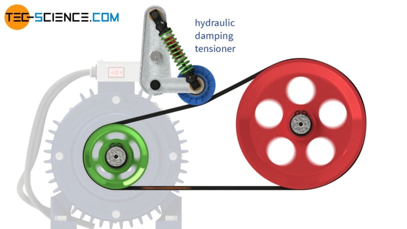

we have a 3 B-Type V-belt tensioner for engine with a spring pulling the tensioner roller. The spring is then connected to a stud/hook through the cabin and wing nut is used to pull up the spring to increase the belt tension. 2 wing nuts are used, one on top of console and one at the bottom of console.

Using a bigger/longer spring and eliminating the adjustment is the best way to avoid the whole mess.

Regarding bigger springs, I saw this:
The handbrake lever looks convenient.
