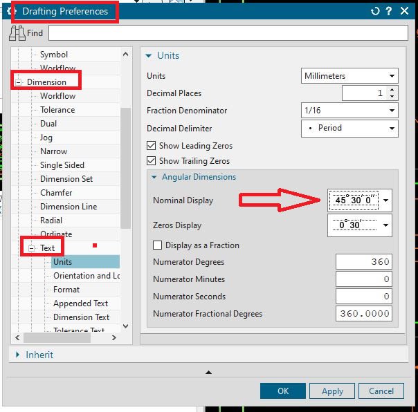

Greetings,
How do you change your drafting to show angles with decimals instead of degrees. Not just one angled dimension, but anytime you select an angle dimension, it will be in degrees?
Thanks,
Brent
If you want to change an existing dimension RMC on it Settings -> Text -> Units
Before the dimension is created go to Preferences -> Drafting
Jerry J.
UGV5-NX1961
Got it, thank you. Actually, for this 8.5 NX, it was under Preferences - Annotation Preferences. Under the drafting preferences, the annotations options are limited.
