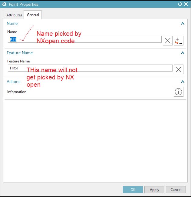

Hi Ram K
Thank you for the journal. Its what I need,I have renamed both two points with PT1 and PT2 but still fail, seems like the points names are not identified." Points names are not correct"
Regards,
Maryadi

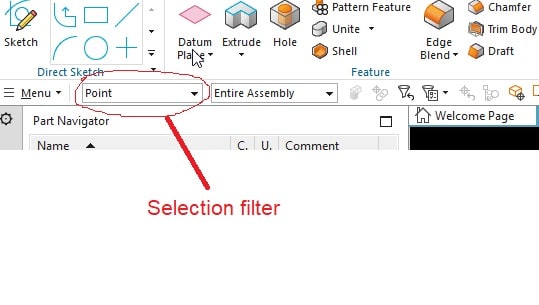

Hi Maryadi,
When renaming , Please set the selection filter to Point and select the points. In your case point features are renamed instead of point object.
Attached image is for reference.

Hi Ram K,
Yes, Perfect. It's work.
Thank you.
