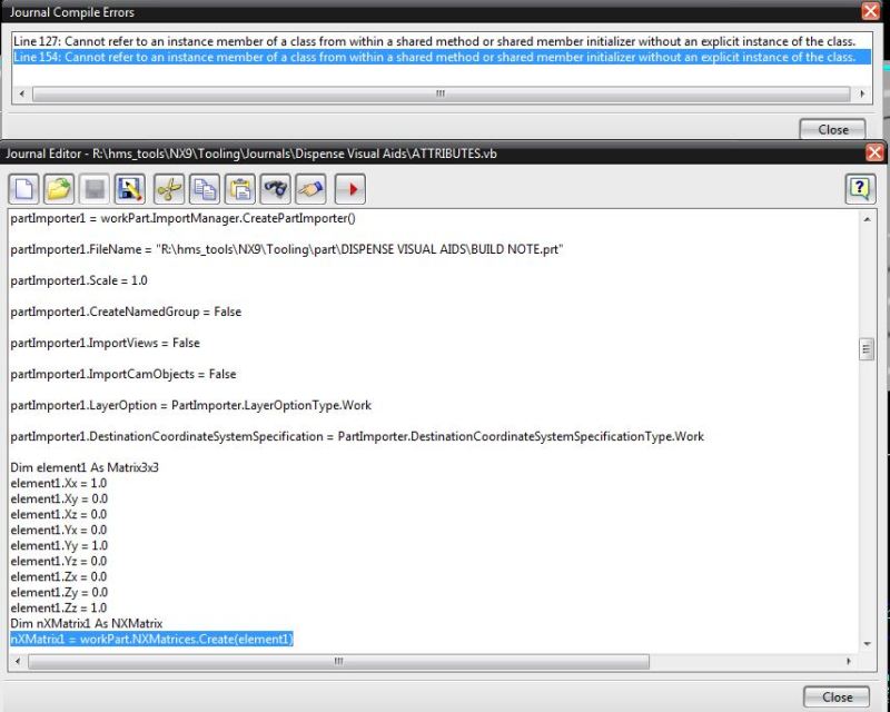

I have code that works for importing files. What I dont know how to do is write .vb code that before importing the part file, it will check to see if three specific attributes are available, and if not, it will promp someone to fill out the info and then automatically create the attributes for them. Then it will import the note's part file.

I get the following error.... the top and the bottom line showing are what gets hi-lighted if I select the two errors
I think I see it. I read the are above that I saw I may not have the DLX file in the right place. Let me see how that does.

i think i found your problem its because main its declared as public shared
