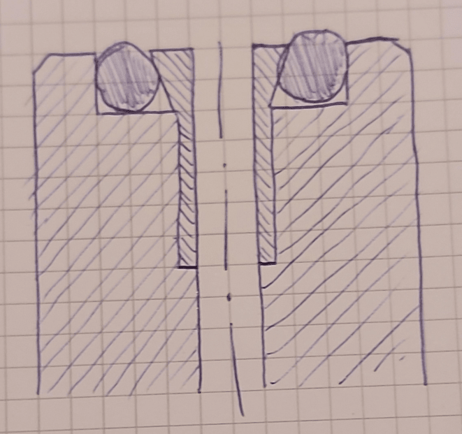

It is small enough one could make it an insert and turn it on a lathe with a belled out end and then rotary burnish it to close the straight groove into a half-tapered groove. If the end is upset too much a cleanup pass could flatten it as required. It would not take much deformation and the insert part can be installed with shaft-locking compound into a hole in the remainder of the test fixture.

@3DDave.
Good idea. Do you mean something like this?
Making the chamfer on the inside would be best because it does not introduce possible leakage.
Problem is, that it is so tiny. The central hole diameter is only 1 mm (0.039").
Making the chamfer on the outside could be a cause of leakage, though.

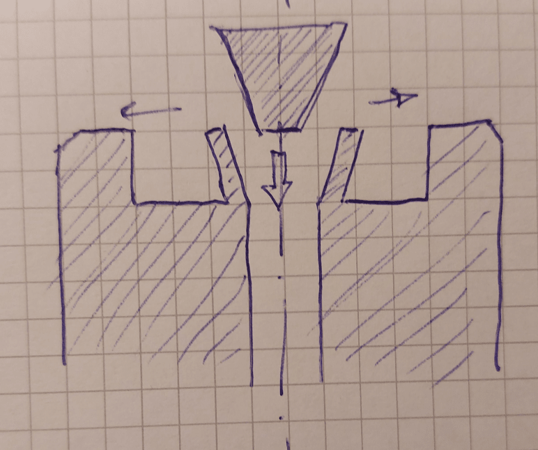

Maybe if I would use a conical tool to deform the inner thin-walled edge like this, to create a dovetail on the inner side.

I really meant on the the OD, hence burnishing rather than jamming a cone into it - the entire cylinder with the groove as one piece rather than adding a tiny part.
O-rings in this instance are sealing on the flat faces, not the outer boundary. The outer part keeps the pressure from causing the o-ring to escape.
