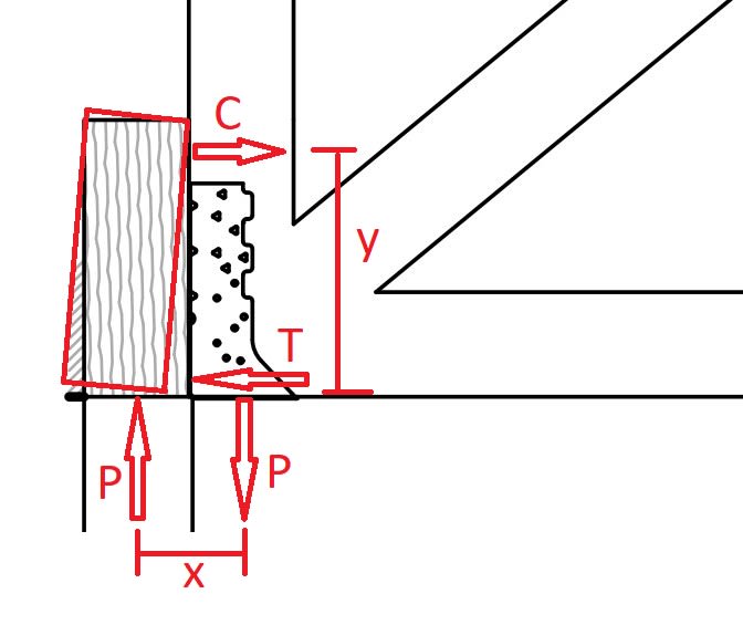

XR250 said:
If you tried to resolve it, it would likely be the last job you got from that customer.
I doubt that, but it shouldn't matter even if true. Following are a couple of ideas.
If the truss end has a vertical reaction P which acts somewhere on the metal connector seat, then the way I see it, there will be a torsional moment, TM = Px per my sketch. This will cause the bottom of the beam to want to rotate away from the bottom of the truss (which I drew as the beam in red). The tension, T, and compression, C, forces will counteract this torsional moment. (I screwed up the direction of the C and T arrows, I just realized. They should be reversed.)
I would expect the C force to be near the top of the beam and the T force near the bottom, separated by distance, y, per the sketch. This makes it possible to solve for T and C. Possibly the T force can be resisted through the connector, or more likely, some direct tension connection maybe like a metal strap down the face of the beam, along the bottom, and along the bottom of the truss. The C force is resisted by direct bearing against the truss. I would also provide some sort of clip there in case somehow the beam were to experience lateral torsional buckling with the top trying to pull away from the truss, or if the truss has an uplift force.
Can the torsion on the beam be ignored? Yeah, perhaps.
Does connecting the beam to the truss in a way which resists torsion force the beam end condition to deviate from the pinned assumption? I think that's possible. And if the beam deflects and the end rotates, does that still cause the beam to rotate in torsion a little? I think so.
I might try to use a top mount connector here instead.

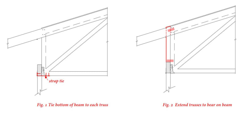

EDIT: BA_Retired beat me with a few good ideas, I just noticed. The detail with the strap is exactly what I was thinking.
Right. Forget my idea unless there's uplift. I got that flipped around. Thanks for the image, Eng16080. I'm with BA's figure 1.
When I get to a 3-ply LVL (5 1/4"), I add straps on the bottom of the trusses/joists that go under the beam and wrap up the exposed face to resolve the tension portion of the couple. Can also use a DTT1Z as I think Pham mentioned.
