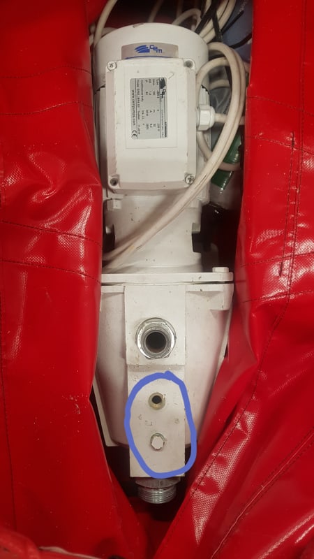

The project;
I am currently working on a pumping system to draw/pump water from the sea, to the access level of offshore wind turbines.The sea water will be used to wash off bird waste that accumulates in large quantities causing problems for offshore operations.
The pump will be a self priming centrifugal pump 230 v 160L/min 5 Bar.
The suction line is 7 meters maximum length, 1.5 inches diameter pipe.The discharge line is also 7 meters but has a diameter of 1 inch.The pipe diameters are matched to the inlets and outlets of the pump design.
There is a non return valve on the suction side 3 meters from the pump, this is to maintain water in the pump body and discharge line to assist with priming.
There will be a control circuit activating the pump at high tides only and during night time i.e. one high tide per day.
Testing of the self priming pump, suction hose,non return inline valve offshore.
During high tide the pump was situated on the resting platform (7 meters from sea level to pump inlet).the pump body was then filled with water ready for self priming.The suction hose was placed into the sea water and the discharge hose was run uptothe turbine access level 7 meters up.
When the pump was activated, i could see that the pump was extracting air from the suction hose through the pump housing and into the discharge hose, the air bubbles and water mixture would rise so far and then fall back into the pump housing. After 5 minutes i turned the pump off and could see the trapped air in the pump housing beginning to naturally rise up through the discharge pipe and out into the open.When reactivating the pump after all the air had vacated the pump casing, the pump performed as it should,displacing water from sea level upto the turbine access level at a rate of 80 liters per minute.
Each time i turned the pump off and then back on, it would activate and start pumping straight away however, when i turned the pump off and introduced air into the suction pipe to simulate the tide going in and out, the pump would not prime and would continue to collect a water/air mixture in the pump casing and fail to prime fully, leading to failure to pump.As mentioned, if i turned the pump off then on to allow the air to escape the casing then the pump would perform faultlessly.
After investigating further into the reason the pump was failing to prime first time, i came to the conclusion that the head of water on the discharge line was not allowing the air/water mixture to escape resulting in air binding thus loosing suction.
My questions,
Is this something anyone has seen before?
Is my conclusion plausable?
if so, would an automatic air breather installed on the pump casing be of use for my problem?
I don't really want to re-configure the control circuit so the pump activates twice as i don't see that as a sound solution to the problem at hand.
Any help will be much appreciated!
I have seen this before. Strangely, it was not as part of my role as a pump engineer. It was at my cabin. The shallow well pump there draws up from about 5 or 6 meters below the pump. With the pump flooded, it cannot prime the suction piping on the first run. Only by starting and stopping two or three times can I get it to fully prime. Once primed, it has stayed primed for years.
I am not sure that an automatic air breather (air release valve) will solve the problem. When it is failing to prime, on the first attempt, it may not build enough pressure to push the air out. I would consider different solutions that may not be practical for you. I would have placed the non-return valve further down in the suction piping. A foot valve near the very bottom would reduce the amount of air that needs to be expelled when priming. Or, you could drain down the discharge piping so that there was not so much head to overcome during priming.
Is there a second non-return (check) valve on the pump discharge line? If not, the head pressure in the discharge line may allow the automatic air release valve to expel the air during priming. I don't have experience with these valves, so I am not sure.

The amount of pressure generated by a pump while self-priming is 1/1000th the rated discharge head. Self-priming centrifugal pumps cannot prime against check valves, trapped water loops, etc. Depending on the location of the pump we often just drill a small hole in the discharge pipe to facilitate self-priming.
Hi Tug Boat,
This is the reason why i think an automatic breather mounted on the pump casing (as there seems to blank on there already,maybe to accommodate a breather?) will do the same job as drilling a hole on the discharge line, as i can visably see the water air mixture trying escape then rebounding back into the pump.

That doesn't look much like a self priming unit to me - care to share the details / vendor?

I mentioned issues I have priming the shallow well pump at my cabin. The picture provided looks almost exactly like my well pump. It is considered self priming because a portion of the discharge is recirculated back to the suction through a venturi fitting that is supposed to act like an eductor and draw in air or water from the suction. The ports you have circled are the ones I use to dump water into my running pump to speed up the priming process.
hmmm The pump is 100 % self priming as i have already managed to draw water the 14 metres head i require at a significant flow rate and pressure as already mentioned?
