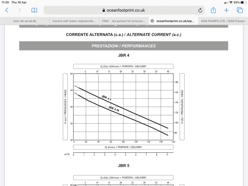

I am currently working on a pumping system to draw/pump water from the sea, to the access level of offshore wind turbines.The sea water will be used to wash off bird waste that accumulates in large quantities causing problems for offshore operations.
The pump will be a self priming centrifugal pump 230 v 160L/min 5 Bar.
The suction line is 7 meters maximum length, 1.5 inches diameter pipe.The discharge line is also 7 meters but has a diameter of 1 inch.The pipe diameters are matched to the inlets and outlets of the pump design.
There is a non return valve on the suction side 3 meters from the pump, this is to maintain water in the pump body and discharge line to assist with priming.
There will be a control circuit activating the pump at high tides only and during night time i.e. one high tide per day.
Testing of the self priming pump, suction hose,non return inline valve offshore.
During high tide the pump was situated on the resting platform (7 meters from sea level to pump inlet).the pump body was then filled with water ready for self priming.The suction hose was placed into the sea water and the discharge hose was run uptothe turbine access level 7 meters up.
When the pump was activated, i could see that the pump was extracting air from the suction hose through the pump housing and into the discharge hose, the air bubbles and water mixture would rise so far and then fall back into the pump housing. After 5 minutes i turned the pump off and could see the trapped air in the pump housing beginning to naturally rise up through the discharge pipe and out into the open.When reactivating the pump after all the air had vacated the pump casing, the pump performed as it should,displacing water from sea level upto the turbine access level at a rate of 80 liters per minute.
Each time i turned the pump off and then back on, it would activate and start pumping straight away however, when i turned the pump off and introduced air into the suction pipe to simulate the tide going in and out, the pump would not prime and would continue to collect a water/air mixture in the pump casing and fail to prime fully, leading to failure to pump.As mentioned, if i turned the pump off then on to allow the air to escape the casing then the pump would perform faultlessly.
After investigating further into the reason the pump was failing to prime first time, i came to the conclusion that the head of water on the discharge line was not allowing the air/water mixture to escape resulting in air binding thus loosing suction.

Just to be clear here, what is your actual duty point?
Your stated 50m / 180l/m are max amounts, but not at the same time.
So for your chosen pump 50m differential head is at a flow rate of less than 20l/min whereas 160 l/min is at a head of 20m.
So which one is more important?

The pump you have produces 25m @ 140 l/min. If your access level is above the pump level then you're either not getting 3 bar or a lot less than 140 l/min.
To be able to source a pump you need to specify a duty point, not just the extreme end points of e pump curve.
Your chosen pump will not produce 50m @ 180 l/min.

My mistake the pump is rated at 160l/m at 50m
By the time you take into account around 7 metres suction head and 7m discharge head, pipe resistance and non return valve resistance I am receiving around 130-140l/min just under 3 bar
Which is more than adequate.

For the last time, your pump is NOT rated at 160l/min at 50m differential head. You are misunderstanding how pumps are rated.
If indeed you are getting 130 l/min, the pressure/head at your discharge point according to the JBR 4M pump curve ( as you're operating at single phase 230V) once you take off the static head is giving you about 12m at the end point. Allow a little bit for frictional losses and the pressure at your +7m elevation is about 1 bar. This seems to be acceptable.
Therefore the duty point to look for in submersible pumps will be approx 130 l/min at 25 to 30m head.
It does look like you fall between a sump pump which tends to be about 10 to 15m and high head down hole borehole type pumps which are >100m, but there will be some units which can do this.

I appreciate your break down and correcting me on the pump rating versus duty point values as this is obviously critical.Whilst i am certain i am getting 130 l/min (which i was able to measure) the pressure must only be at 1 bar.
I will add, it is an unknown at what pressure i will require at the outlet spray nozzles however, this is part of the point in constructing a test rig on one turbine for a number of months before rolling it out to the fleet.I suspect 1 bar will be adequate as a good storm goes some way to cleaning the access areas as it is.

Quick question. On your test, what did you have on the end of the pipe to control flow?
to control or to
measure the flow?
Control
If you just had an open end pouring into a bucket or something then you didn't have a pressure at the end of your pipe. As soon as you introduce a restriction to get a jet of water to clean of the bird poo you start to go left on the pump curve and hence may not get your 130l/min.
Hi Littleinch,
yes just an open container with a timer to get the l/m is all i had to hand.
I see what you are saying about introducing a restriction however, if my duty point is 1 bar at 130 l/m and i match the flow rate of all the nozzles combined to 130 l/m ensuring the nozzles are also rated at 1 bar then should i not expect to maintain the duty point pressure/flow overall?
OK, What I think you did and please correct me if I'm wrong, is you have a pump with about 7m lift (suction) to your pump, another 7m up to the end of the discharge hose which was open to atmosphere and into your vessel.
Hence the pressure at the end of your discharge hose is essentially 0 barg.
So you have 14m of lift plus what seems like about 7 - 10 m fictional losses ( you're running about 4-5m/sec in your discharge hose)
This equates quite well with your 130l/min on the pump curve.
The issue now is that if your spray nozzles impose an additional pressure loss / need say 1 bar to operate properly, this adds 10m to your duty. On your pump curve you now only get 80 l/min. In reality there's a bit of give and take ( frictional losses reduce so you might get up to 100 l/min.
The devil is in the detail of the pump curve. the risk is that too many nozzles will result in low end pressure and low veljet velocity. So you end up more with a sprinkler system than a jet wash.
What you really need to do is test one of your nozzles / spray heads and see how much pressure/head it needs just upstream to develop the spray velocity you are looking for and measure the flowrate from each nozzle. Then figure out how many nozzles. This gives total flow needed.
Then add the static height from the sea level to your nozzles
Then work out frictional losses in your pipes and fittings.
Add it all up and that becomes your pump duty at the total flowrate from the number of nozzles.
But things never work out exactly, so allow for turning off or adding nozzles to your system when you test it in earnest to get the spray velocity you need to remove the guano.
