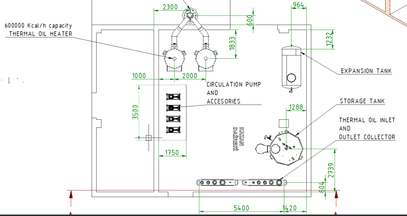

Dear All,
My Client is planning to install 40m3 vertical ng operated boiler, 2 units of storage tank where each has 3000 litre capacity for oil storage.
As per the nfpa with which design number must we follow for.designing such boiler room? Aside from that is it compulsory to have foam based extinguishing system ( if so nfpa reference please)or can we simply rely on esfr sprinkler types.
In order to avoid any explosion damage local fd requests the blast resistant wall to be constructed along the adjacent edges of boiler room with existing building. As a result to do that Structural engineers requires the lateral blast energy in terms of kN/m2 on walls roofing foundation which serve as basis for design of those structural elements. How am I supposed to that ?
Your guidance will be appreciated

Here is the layout
[URL unfurl="true"]https://res.cloudinary.com/engineering-com/image/upload/v1656166434/tips/layout_ygtdqi.bmp[/url]

Well actually boiler room will constructed where it shares the common border with the existing building (ware house, production area), oil heaters and expansion tanks are not positioned close to the adjacent building they are positioned more on the outer wall of boiler room, it definitely is more logical and expedient for the blast release direction.
Yes there will be tank bund, where the capacity of that will be 2000litres. The blast wall is needed by local Fire department but no one knows on what basis. That's why I'm trying to figure out.
Is it mandatory by NFPA to use water based extinguishing systems(e.g. sprinklers) or can end-user choose the type of fire protection , foam, carbon-dioxide, steam and chemical?
Along with that is it mandatory to construct the blast resistant wall by NFPA regulation ?

You're getting into deep water here. NFPA are a set of codes which can be very difficult to work through and add on local regulations and people like the fire dept and other officials and you really need a local "loss prevention" company or engineer familiar with both to help you through.
Unless your local legislation requires compliance with NFPA then nothing is "mandatory".
Waste is not always the answer and in places like switch rooms and electrical buildings they use gas instead of water.
Never heard of steam being used though....
Also note insurance companies can get involved as well....
