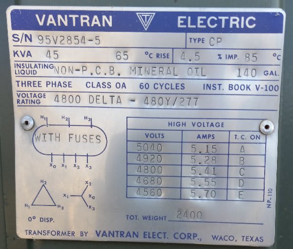

I have some nuisance tripping of distribution line fuse links feeding a pad mount transformer. I suspect the fuse is not appropriate for the transformer. The transformer is rated at 45 kW, primary voltage is 4800, secondary is 480. The load is a 40hp motor with a soft start/stop so the inrush is zip. The blown link was a 7 amp K fuse. If I assume the transformer P.F is .8, the transformer would be rated at 56kVA? Is that correct? IF that is true, the line fuse link should be about 10 amp and I am thinking a slower fuse link would be better like a type X or?
Thanks for any advice.

Well I guess I should have opened the door. I was sure the rating was in kW-oops. Here is the data plate behind the green door. I still am questioning the 7 amp K fuse on the dist line that blows every few years. Costly to bring out a lineman. Hence my wish to change the fuse links to 10 amp slow blow. The power line is my private line and Edison is feeding it with three 10kVA transformers where I have three 45 kVA pad mounts running on my end. Two close to full load at the same time. Seemed a bit cheap on the Edison side.

I'm not familiar with a 7A "K". What I see are increments of 1, 2, 3, 6, 8A and so on. An 8A "K" should technically work unless you have a motor that is really, really eating up inrush current in the 290kVA range after 60 cycles. The fuse that transformer SHOULD be fused at is a 7A KS. I suspect that's what you have. That's the perfect fuse as it's as high as it can be before you start getting into the damage curve of the transformer. Make sure you're using 7A KS fuses and if it's blowing, you have another issue.
This is assuming you have a 45kVA 3ph Tx with a 4800V delta primary (or 4.8kV WYE). I don't see an issue with a 40HP motor. The transformer curve for a 45kVA is 650A @ 0.1 sec, 327A @ 1 sec, 163A @ 10 sec. That means your 480V motor could pull 163A (135kVA) 10 seconds into startup and your transformer and 7A KS would be fine.
With regards to the upstream 10kVA's - I assume you mean that the utility steps down their distribution voltage to 4800V delta with a closed delta bank of 10's, equaling 30kVA. Are their fuses blowing?

Cranky - yeah, I'm sure this building is old and had a 4800V delta svc from the utility. The utility probably upgraded to a 12-25kV WYE distribution system and just stuck a small stepdown where there used to be a primary meter. It sounds like this plant owns some 4800V distribution they pay someone privately to maintain bc the 7A fuse is an Overhead fuse, feeding a dip. Understanding the service details would help me to make sure I'm not missing an important detail.
