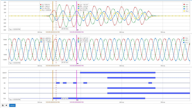

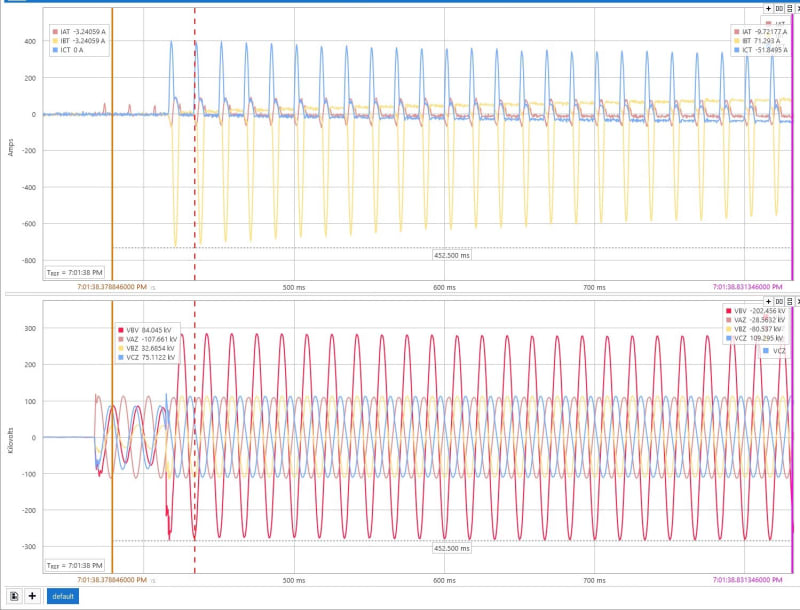

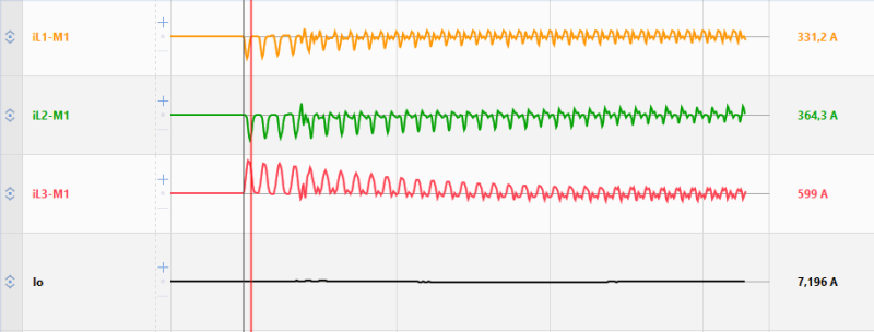

Hi All,
I have attached screen shot of Transformer inrush current during energization, we suspect this is due to some problem in the primary circuit and checking the possibilities. Sometimes transformer gets energized without any unbalance in current among phases. Due to unbalance in current Transformer HV SEF Protection is operating after 1 sec delay. My query is because of this unbalance transformer phase current inrush current last for more than 1 sec and to avoid nuisance tripping during energization can we enable second harmonic blocking in the SEF function to block the tripping.
Channel details:
1-A Phase
2-B Phase
3-C Phase
4-N Measured Trf Neutral current.
