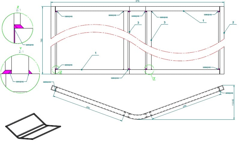

Hello.
I'm asking for help.

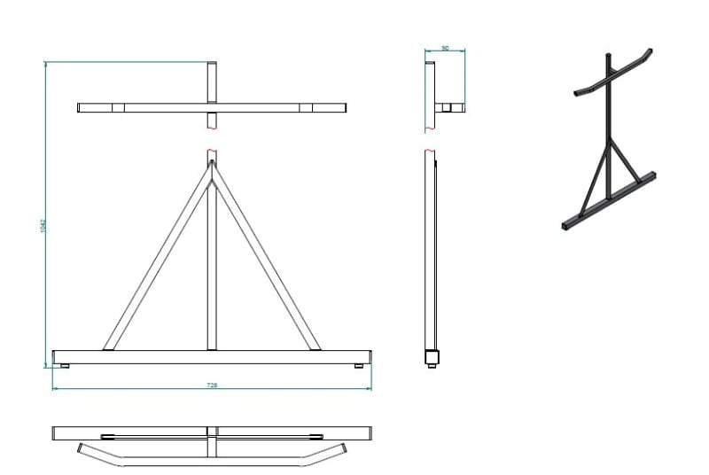

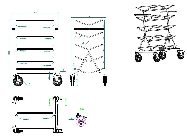

Is there any way to optimize this design? The welding should be kept.
This is the cart on which the shelves are placed.
I have only one idea so far - remove one Bar on the "support_hor" component and move the second Bar to the center.
And perhaps to reduce the thickness of the structure profile wall. Now it's a square thin-walled profile.
I've got a default Catia v5 FEM module for structural analysis. But if I understood correctly help documentation, it can only solve linear problems, and for assemblies you need a nonlinear solver.
If I am wrong, please help me to make a calculation diagram for this cart. I think everything is clear here with the load - distributed vertical load on the part "Support_hor".
I don't know what boundary conditions should be set.
Maybe just fix the two lower horizontal bars?
Load on the shelves - I don't know yet, but let's assume 30-50kg.
The material of the frame is just galvanized steel.
My skill level in FEM - beginner, a couple of times made analysis for a simple sheet bracket in Catia v5.
Regards,
reutov-tv
 https://files.engineering.com/getfile.aspx?folder=d82b8de3-0d46-4afd-af1c-5ba9e3d6f530&file=ASSY.jpg
what are you trying to optimise for ? weight ? cost??
what are the constraints ? Do you Need 5 shelves ? Do they all have to have the same load carrying capacity ??
agree - optimize for what? why?
"for assemblies you need a nonlinear solver" - nope, this is nonsense.
You are going to need accurate material properties. And some strength data for the welded joints.

what is stated in CATIA doc is correct, BUT, you don't need to include contact or bolt tightening or similar in a FEM to have a useful assembly model. And for beginners, I very very strongly recommend not using any contact or other non-linear features until you master the basics of linear static FE analysis.
The most suitable way to specify fasteners for a FEM is to NOT include them; just contact the parts together in the model, extract local forces, and calculate fastener loads by hand outside the FEM.
Your structure probably can be quite well modelled only using beam elements.
Not familiar with the Iso Restraint function. Strongly recommend setting up your own constraints so you learn how those work, and not just using some black box thingy.
To estimate "weakest points" you need to understand strength of materials and failure modes. And don't forget to check buckling failure modes of the structure, not just static strength.
Welding - ugh - the material properties are different in the area of the weld, both in the base material and in the weld material; the weld material geometry is complex and has to be idealized; and many more complications; you will need weld strength test data for your assembly components.

Forget using FEM on this thing for right now. Go back and brush up on statics, strength of materials, various failure modes etc. so that you can analyze this thing by hand first. It's relatively straightforward (it's just a bunch of beams/columns). To perform an FEM analysis that is of any use, you need to do at least some basic hand calcs anyways (to make sure your model is at least somewhat connected to reality), so you'll need those hand calc skills either way.
