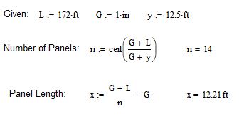

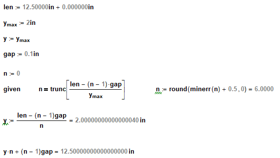

I am looking for help with a optimization routine that will replace the trial and error method I normally use.
I am trying to find the least number of panels for a given length (L) and gap (G). The panel width (x) also needs to be less than a specified width .
Thank you.
