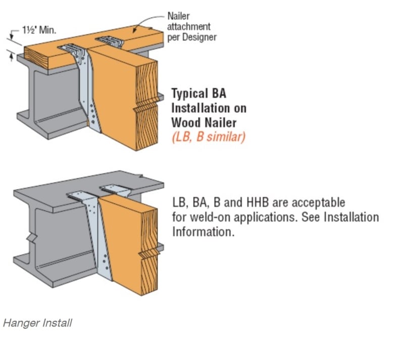

@phamEng that is an interesting concept and may be the way to go. The existing rafters are 2x6's; if I can somehow cut/remove the wall plate and cut the rafters flush and place a steel beam where the rafters are and attach the rafters to the side of the beam, that would give me an additional 6" to play with. Total space would be 9.25", which would allow a proper 6" or 8" W beam to be installed. However, how would the connection of the rafters to the steel beam look? The rafters are pitched.
Would it be something like this but with the rafters notched to allow for the pitch? Or is there a typical type of detail for pitched rafters to steel beam connections?
You also mention that the steel beam can be strapped to the existing adjacent wall plate. What would that look like?

If you have to go with steel, the detailing is a little harder. But I'd bolt lumber to the web and use a twist strap between it and the top plate of there's room.
