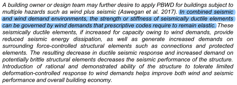

@milkshakelake - Do you mean that the shear walls will crack at the lower stories? It sounds like you may be talking about cracking and not yielding. My understanding is that the building MWFRS is expected to remain elastic for the design wind event. There is some work in its infancy that is looking at allowing limited inelasticity in the MWFRS under wind loading that would be particularly beneficial at sites with large seismic loads (Link). The elements experiencing inelasticity would require additional detailing to achieve the toughness required for excursions into the plastic range.
@StLHokie - A compressive stress of 1.0f'c and above would exceed the design strength of the concrete, right? A traditional design using the Whitney stress block would limit the compression stress to 0.85f'c, so you shouldn't be experiencing stress higher than that for wind load.
That is not my understanding for ULS wind design. Or, at the least, I think that it needs additional nuance. I see it like this:
1) When it is said that the code requires lateral systems to remain elastic for design wind events, I think what they mean is that inelastic energy dissipation is not part of the program for ULS load resistance. We're not counting on deep, cyclical excursions into seriously inelastic behavior. And this is consistent with our usual treatment of wind as a pseudo static load.
2) When a designer works out her ULS wind load and then specs shear wall boundary reinforcement via Whitney stress block etc, that exercise implies reliance on the plastic cross sectional bending capacity of the shear wall and yielding of the flexural reinforcement. I believe this to be the sense in which MSL referenced "yielding". And I feel that it stands as a valid point.
I appreciate the nuance. However, it's certainly not a forgone conclusion that plastic design methods will lead to MWFRS yielding in the design wind event when you consider conservatism in analysis and proportioning, strength reduction factors, material overstrength, etc.
I believe MSL meant to reference cracking and not yielding, but I do agree that if limited yielding were to occur, standard detailing would be sufficient to meet ductility demands. Seismic detailing would be excessive, and the use of seismic provisions to evaluate the need for boundary elements to resist wind loads would be inappropriate.
