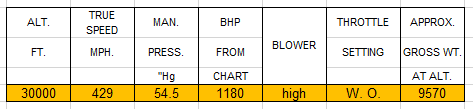

From wikipedia the following aerodynamic data can be derived, CD0=0.0163, drag area=0,355m^2 and a best L/D=14.6, it’s very good for a single engine tractor fighter aircraft, don´t get me wrong!
From Memo Report No. TSCEP5E-1908:
So at 30000 fts the engine it’s not producing anymore 1490 BHP, but 1180 BHP on War Emergency Power to achieve 439 MPH, this shows how efficient the aircraft was.
So some conclusions, the P-51D has a best glide ratio of 14,6 and a engine (Packard V-1650 Merlin) with a SFC of 0.50 lb/hp/h.
