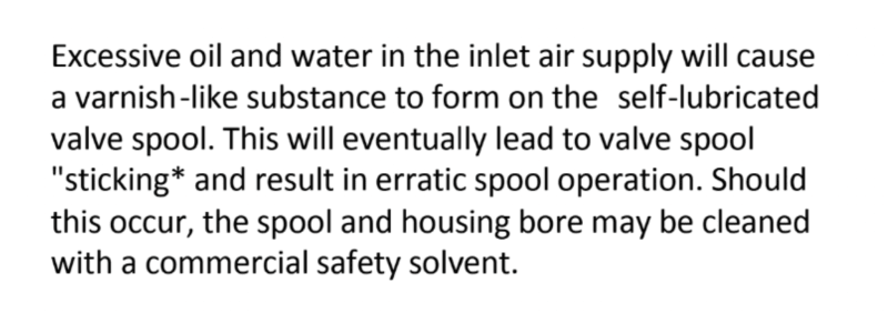

Are you using an oiler in the air supply to the pump? Oil should prevent frost from jamming the valve. Frosting is common, but I have not observed the pumps freezing-up so they do not work.
You may need better driers. AODD pumps use a lot of air and drier performance deminishes as air flow increases
NO! Do not run oilers on modern AODD pumps. The oil can damage the valves.

I repeat. Do not use oilers on modern AODD pumps.
From one manufacturer:
Virtually all AODD pumps today have some form of lubrication free shuttle valve. These range from some form of carbon/ceramic setup to nitrided shafts in PTFE seals.
I may be a bit confused by antifreeze lubricant. Glycol is an acceptable additive.
To somewhat support Tugboat's post (from another manufacturer we use):
