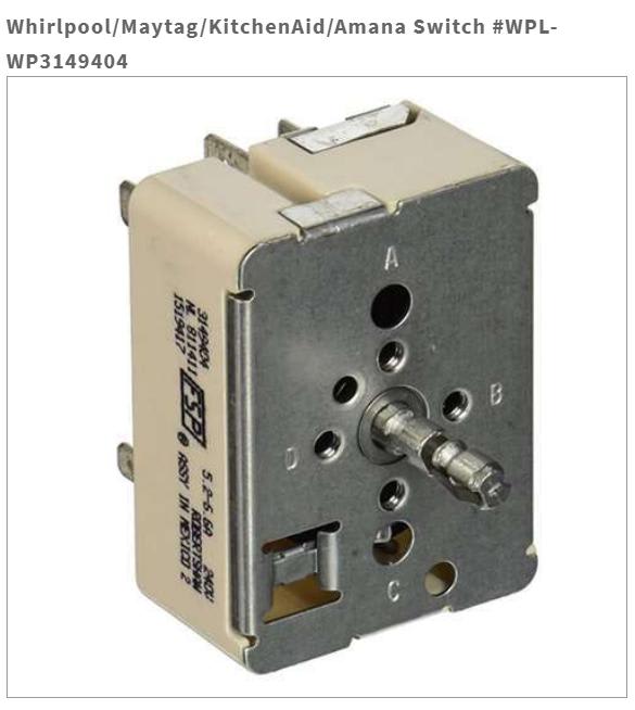

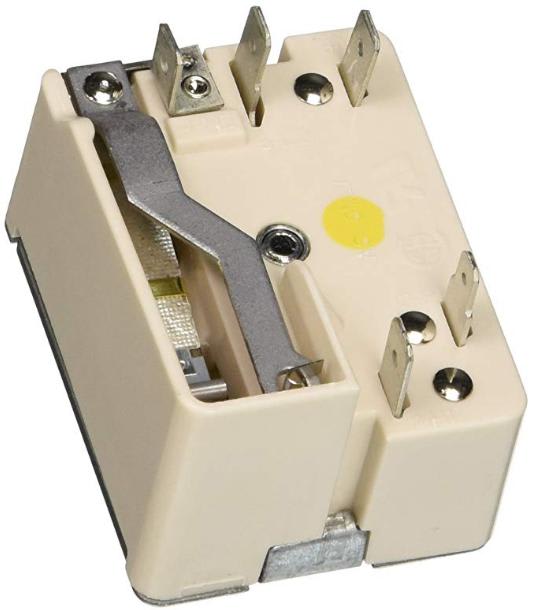

An old old idea.
Ford engines used a similar idea in their gauges as far back as in the '40s.
Two bi-metal strips wound with nichrome wire and connected in series.
The sender had a contact that was moved by the measured variable.
For instance when the oil pressure increased, the contact would push against the bi-metal strip. The current would flow until the bi-metal got hot enough to bend away from the contact.
The nichrome heaters would cycle both bi-metals together.
When the sender bi-metal moved away from the contact the current was interrupted and it would cool down and make contact and repeat the cycle.
The receiver bi-metal was connected to the indicating needle.
