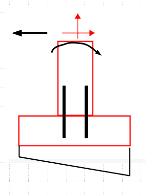

For moment frames, I am a pretty big fan of grade beams connecting all of the participating columns in a line.
I should have expanded upon that. I do it because I have a very strong preference for moving the shear through the foundation of the compression column.
2) Columns that land directly on footings with no intervening piers.
That is very interesting for me, could you please elaborate how piers participate?
Thank you.
Regards
Elaborate?? I already drew you a picture of it. If you need more than that, you'll have to ask me a more specific question.
I am sorry about that, at first I did not understand. Now is clear, thanks for your help!

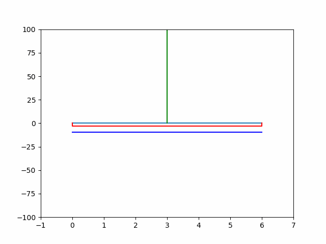

Simple animation of Foundation pressure increase (red) and rotation (blue) as eccentricity increases:

I'm making a thing: (It's no Kootware and it will probably break but it's alive!)

As phamEng suggested, I suspect that this may indeed be just a semantic thing. When I look at your sketch below, and read your description of it, that sounds to me like designing the footing for overturning. Your scheme is, verbatim, how we used to design shear walls for overturning in buildings with basements back before computers were available.
