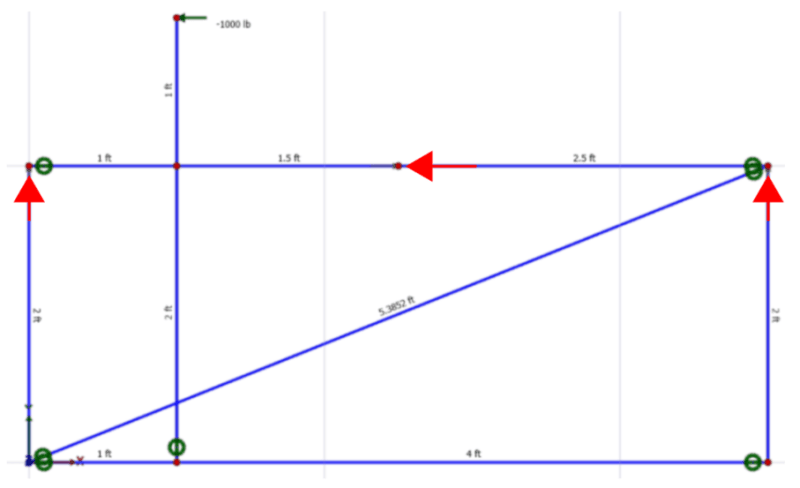

Allowing the deck to take the full lateral load, I created a model that confirms the following:
•Lateral load goes to deck (via a horizontal collector)
•Moment is taken out as (2) opposing vertical loads at each joist.

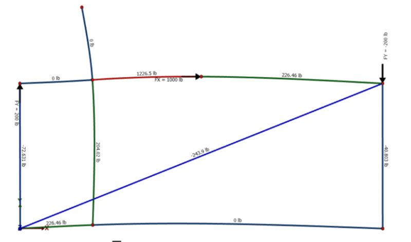

However, what I'm not understanding is why the nodes of these model don't appear to be in equilibrium. Take the node support at the upper right hand. The sum of vertical forces doesn't equal zero.
I take this model as statically indeterminate and realize there are virtual methods to solving it. Does anyone know of a quick/simplified method to determine these internal forces?

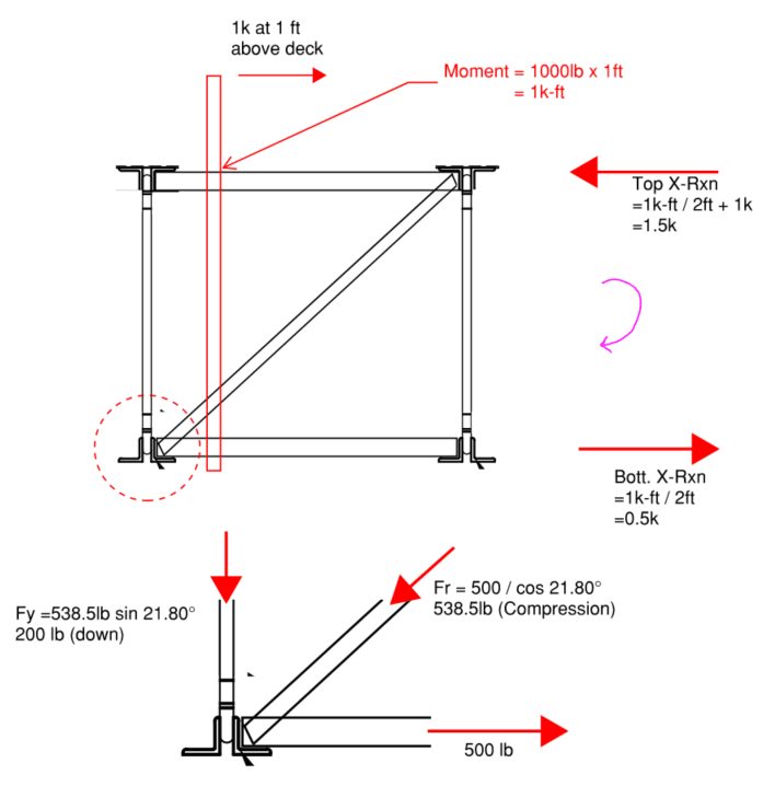

Initially, I thought the bottom horizontal would have a tension value equal to (1,000lb x 1ft)/2ft = 500 lb.

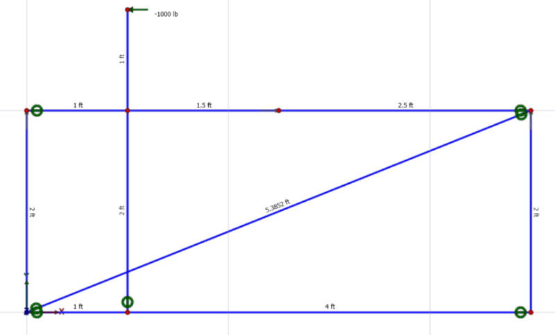

There's something odd going on with your model, it's not realistic for all the load to go horizontally into half the piece, (* 0 / 226 and 0/1226/226.). If you design it this way it's probably safe (upper bound theory), but it's not the actual force distribution because the vertical element is putting all the horizontal load into one side of your horizontal elements. If it's all welded the welds are equally stiff, so there should be a different load distribution on the lower and upper horizontals.
I don't see any supports (pinned) on the whole frame so those are either shut off or ?.
Draw the forces on the joints and the appropriate angles as a free-body diagram? Apply joint equilibrium.
I got tired of chasing this one around. I don't think there is any direct solution the way I'd like there to be. I chalk this up to "here is an accepted method to bracing these loads", without the direct analysis to prove how it works. Maybe through testing? Maybe through historic experience? Or the super simple FBD I've shown below.
Trying to create of model of this thing was probably a waste of time. Regarding my model, the only x-reaction support is located along the top member at mid-span. This is the reason why there is zero x-component force to the left of the vertical.
I'd much rather analyze with this simplistic and more conservative approach.
I dump 1.5K into the roof deck with attachment to the horizontal angle. The balance of the forces 'exits' the FBD as a vertical reaction (equal and opposite) at each joist.
What are you using for the joist spacing then, it's a 24K series for the design concept, that I get, but I don't feel like going all arccosine on it. It should resolve into a lateral load (in the deck, which is corrugated into the plane of the page and axially stiff, and a couple on the two joists up/down to counteract the rotation induced by the 1' x 1,000 lb. load. Is it actually 1,000 lbs here or it's a "unit" load for study?
It was a unit load just for exercise. The joists were assumed 24" deep and spaced at 5ft c-c.
So what you're basically saying is, let all the lateral load develop into the deck and take the rotation out as a couple between two joists? That is pretty much what I have done in the simplified scenario, with the exception that I've used the bracing to take the rotation and deliver through a system of 2-force members to the joists.
Notice in my example above, the vertical load is 200 lb down at one joist (and 200 lb up at the other joist). This is a force couple = 200lb x 5ft = 1,000 ft-lb (the same as the load in the system).
I think we're on the same page but it felt like you said it differently.
Sounds right. 5' spacing is pretty reasonable, if you're going to use "normal" 1.5" metal deck.
In reality you don't know how exactly the forces are going to distribute out, but so long as you satisfy statics and equilibrium it should work as it's a lower bound solution? I used to know this stuff when I was doing more connection design.
This is along the lines of the argument I'm trying to invoke. It's been a while.

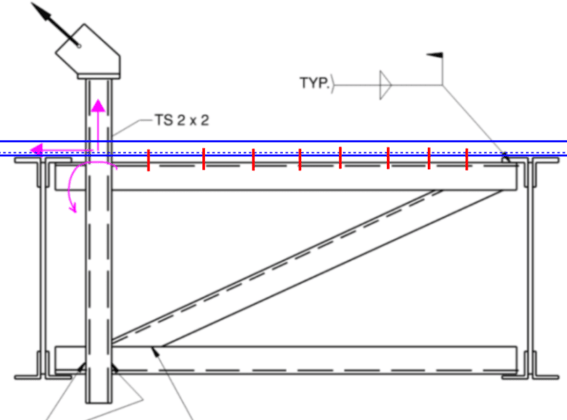

Through what mechanism do you dump the 1500# horizontal load into the deck? It seem like that would take a lot of deck welds working perfectly in concert (and not unzipping).
Fasten the top horizontal member to the deck with #14 metal screws. Considering there will be a gap equal to the joist's top chord L thickness, let's say 3/16", you could determine the allowable shear load on this fastener considering (Bending + Shear ≤ 1.0), this would be around 115 lb per anchor.
Force is 1.0W, calculation done per ASD.
(1500lb x 0.6) / 115 = 8 anchors equally spaced between joists.
Limiting shear on the deck screw for a 20ga 33ksi deck would be about 200lb shear per #14 metal screw.
Remember that 1,500 is a "scale" value for a 1,000 pound point load, it's not an actual value at this point. It's a "unit" load, but the unit is a kip.
Absolutely. JLNJ was asking about the mechanism so that was the simple illustration. I promise this isn't my first time [wink]

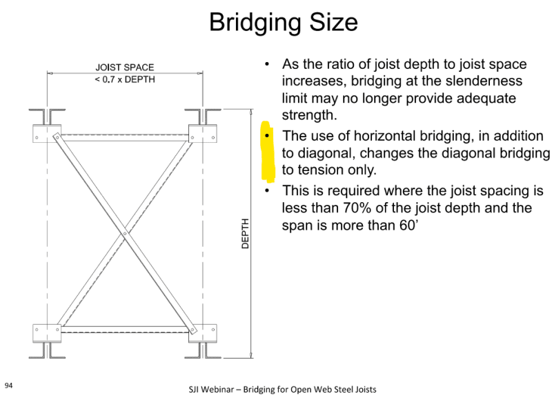

I took the following snapshots from the SJI's Technical Digest #2. When they discuss diagonal cross bracing, they mention that it's designed for tension forces ONLY.
Putting together a FBD of the brace force, where Pbr is determined by Pr/joist depth... it looks like relying on the diagonals for tension only creates forces the adjacent brace into compression. Or else the joint is unbalanced. Take Joint A for instance.
Why am I not seeing it?
I've only just started reading this thread, so I apologize if this has already been discussed. I think the distinction is that X-bridging becomes tension-only when it is used in conjunction with horizontal bridging. If x-bridging exists without horizontal bridging, then they are designed for tension and compression.
Doesn't X-bridging without horizontal bridging only exist for erection stability and permanent bracing?
I don't see how this would be used to support applied external loads such as the case shown above. If so, then there is no mechanism to brace the bottom chord of the joist. The joist would be left with some soft of unbalance lateral load pushing it out of plane (it's strong axis).
Fasten the top horizontal member to the deck with #14 metal screws. Considering there will be a gap equal to the joist's top chord L thickness, let's say 3/16", IMO this is a very bad idea. Do not intentionally put fasteners in bending. Much much better to put an additional plate into the gap.
@StrEng007 - This is from an SJI presentation and is what I was referencing. I need to do some reading and catch up on the rest of the thread to see what you mean about external loads.
