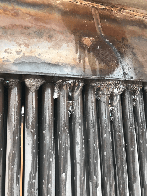

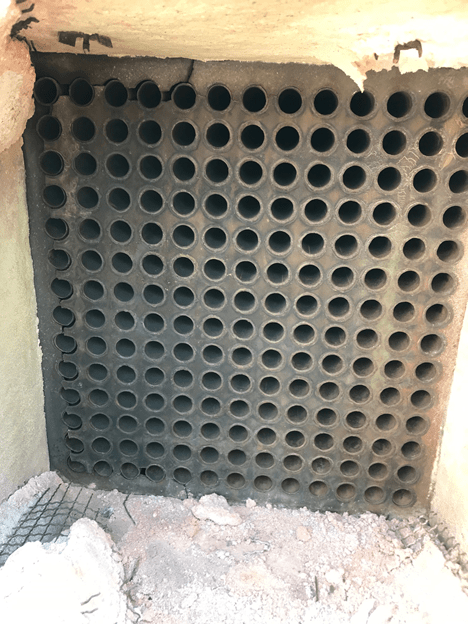

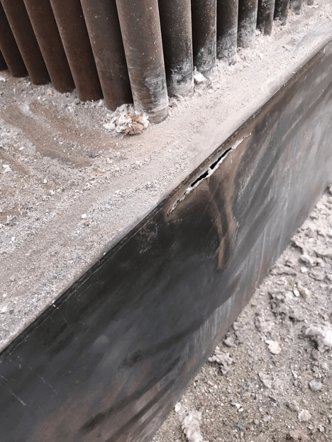

We pneumatically leak checked the economizer (or recuperator, if you will) in place at 1 psig. Upon closing the valve, the pressure dropped to 0 within a couple of seconds. All gasket connections were bubble-checked, so the leak had to be internal. Fortunately, this is a removable-bundle type. We pulled the economizer out and lifted the bundle out. A significant crack was found on the floating head side (not sure what to call it, so I'm just calling it the plenum box for now).

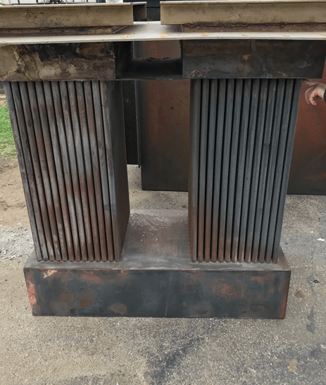

We repaired the crack on the plenum box, and again pneumatically tested at 1 psig. The bundle still did not hold pressure, taking ~30 seconds to drop from 1 psig to 0 on the gauge. Throttling the inlet air valve to maintain 1 psig on the bundle, I soaped the tubes. The resulting test pictures are below. I estimate 15-25% of the tubes are leaking at the tubesheets, both on the plenum box and on the inlet/outlet tubesheets.
At this point, it looks like we just need a new bundle. Does anyone have any further suggestions?
