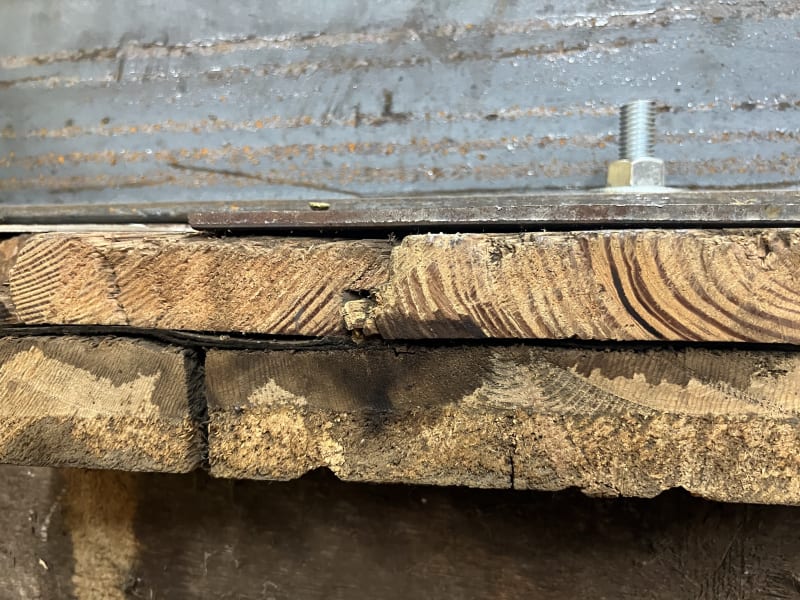

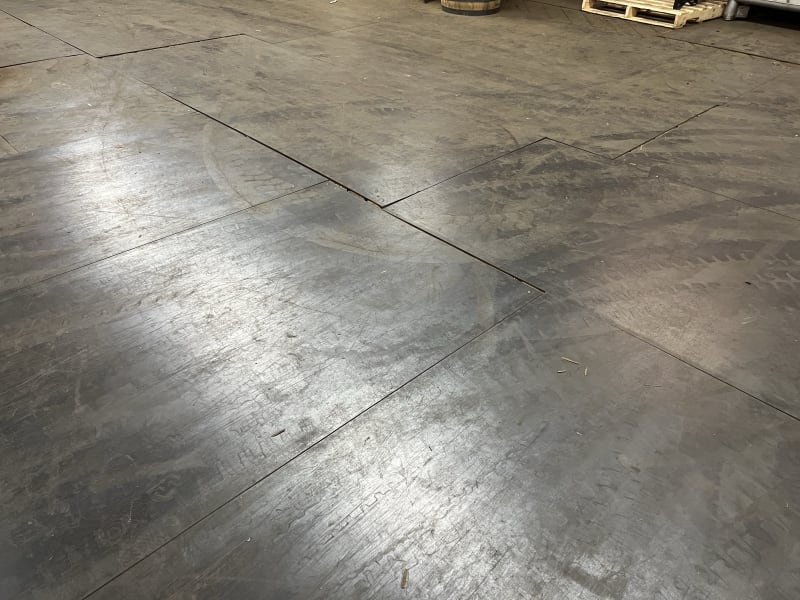

Add another layer of very thick plywood. Add a sheet of asphalt paper or something compressible on top of the plywood deck. Then add 1/4" steel plates 4'x8' screwed into the plywood deck. The steel plates should be screwed so they don't move around, maybe something like 12 screws per plate (with pre-drilled holes). The compressible layer is so that the edges of the steel plates don't punch into the plywood.
The pic below shows this approach (with diagonal planks instead of plywood). The only issue is that the steel plates weren't screwed in, so they moved around. The asphalt paper was put between the planks, which doesn't make sense to me.
As for the framing, you know what to do; just standard reinforcement, sistering joists, possibly shortening the spans with supports/beams/columns/foundations, bridging, etc.
