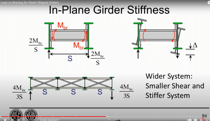

Hello Guys,
I have the following frame( Showing only the necessary part of the structure for the understanding of the problem). The Span is 9,00m(30ft) and the intermediate beam is suporting non-structural masonry. In order to increase the stiffness of the frame, share a part of the load of the intermediate to the top beam and give better suport to the masonry wall, i introduced the green ties. My question is, if i utilize rigid connections, the ties will brace the beams for LTB(Torsional bracing)?
Is there a document that deals with this kind of bracing?
I don't think that it won't be as effective as a traditional bracing where the beams are on the same horizontal plane but may be sufficiente.
Thanks in advance.

@Italo01: If you're feeling sporting, I feel that you could run the model shown below to demonstrate "proof of concept" for your proposed bracing scheme. When in doubt... strip stuff out. Compare a run with the frame as shown below to another run with just the low beam all by itself.

Kootk, i did what you suggested and the results are in good agreement with the theory of beam bracing.
I analyzed a W150x13 (W6x8,5 in imperial units) with 3000mm of lenght and two bracing(Lb=1000mm). The top beam is equal and these are spaced also by 3000mm. The following chart shows the elastic critical moment for LTB for varying values of Ib(Moment of inertia of the bracings out-of-plane. (The gray and orange lines show, respectively, the critical moment for unbraced and braced beams).
Utilizing the methodology proposed by Yura i found that Ib necessary for bracing is 110cm[sup]4[/sup], which i think its in good agreement with the results since Mcr is equal to 93% of the value for complete bracing.
The model didn't consider the position of bracing, which I think that can be done by the introduction of rigid bars with length equal to half of the beam height, and the stiffness of the connection, which can be done by the change of the brace stiffness to a equivalent stiffness.

That's great work Italo01. Thank you, both for taking the time to investigate this and for reporting back on it.
