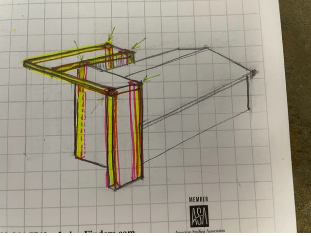

I was wondering what the constructibility would be on something like this in the sketch. I have a concept for a building with a parapet wall at the front which includes an accent overhang of 2-3'. I've seen this look in many modern projects but its usually tied to the main structure of the building. Would this be possible with traditional stick or metal framing? Thanks

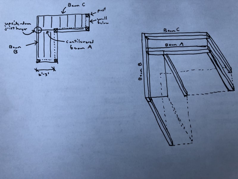

Not sure if it helps but I would probably stick frame it per this bad sketch:
Beam A cantilevers over post at inside corner. Beam B is supported by Beam A with upside down joist hanger, and Beam B supports left end of Beam C. Not sure best way to run joists. They’re shown running up-down per plan view, but perhaps left-right would be better to resist potential twisting of Beam B considering it’s supported along the inside face.
At the outside corner where Beams B and C meet, I would check the total deflection and make sure it’s reasonable.
Again it really comes down to the loads and geometry in terms of whether or not wood framing works.

No to rain on anyone's parade, but doesn't Eng16080's schematic have a column in precisely the place most of these sorts of 'modern' designs hate them most?
Look at your original sketch. It's all about thin, gravity defying cantilevers. Stick a column on the corner and wrecks the whole aesthetic. I might be misunderstanding Eng16080's sketch, of course, but I'm not sure how else it would be stable (especially if using wood).
My sketch is a little wonky and disproportionate and his is sort of a top down isometric, but if I'm understanding his sketch correctly it should be something like this.
Well...there it is. My eyes have been opened!
Though scale will be important. If that's a whole building, I doubt it would work with commonly available lumber/timber sizes. If it's a feature on the corner of a parapet, probably good to go.
