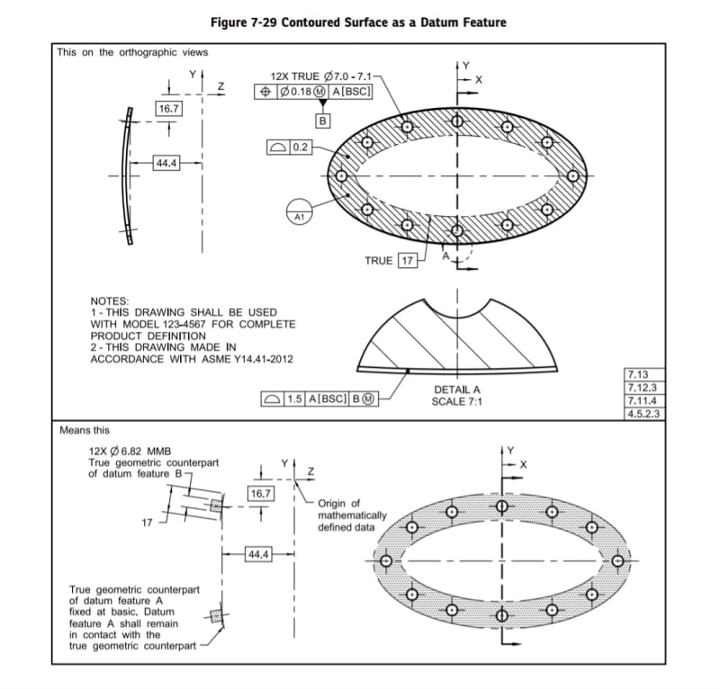

I have a customer-supplied print that calls out a Parallelism inspection against Datum D. However, the feature they have defined as Datum D is a non-planar complex surface (it looks flat on the print, but it's not). I have been arguing that we cannot measure Parallelism as currently defined, but the customer insists that the print is correct.
Am I wrong here? I just don't see how this could possibly be measured. I'll be the first to admit that I am far from a GD&T expert, but unless I've completely missed it, I don't see anything in Y14.5-2018 that would support their argument.

If the problem is establishing a datum plane based on the non-planar surface, It is generally possible. But the relationship between the datum reference frame and the complex datum feature has to be fully defined, and the datum feature should be referenced as BSC (basic). See the below example from ASME Y14.5-2018 (datum feature A).

Thank you for the info/reference, I think this supports my argument that parallelism cannot be measured as currently defined on the print, as there isn't a defined plane for the feature to be parallel to; am I interpreting that correctly?
Yes you are.
Feature shown with datum feature D symbol (and profile callout) does not have any basic radius therefore I interpreted as a nominally flat feature. Again, I am not talking about the "as produced" feature, but as designed feature. As produced feature could be "bow" within 0.4.
And then, at least at this point in time, the parallelism callout looks legit.
If more evidence is presented I will stand corrected.
