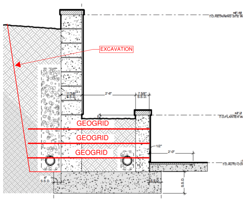

I have a retaining wall on two sides of a residential parking area. Due to property line issues, the heel of my footing is very small. As such I have a sliding problem. I tried a keyway but it was not very effective. How do y'all feel about me using the parking slab for the additional sliding resistance? Ok to use expansion joint material and just let it slide a tiny bit? This is the architect's drawing, not mine.
Thanks for all the responses. As I said in my last post, 2 ft. does work so I will likely use that. It is a rocky site so it may be a challenge to even get that 2 ft.

This is more money, but what if you drop the footing another 1.5 to 2ft? Then, you can pick up some more passive pressure?
It is close to the property line so they are worried about slope stability during construction. The deeper the footing, the steeper the excavation.

bones206, per the OP, I think the property line is on the heel side of the wall. That means MSE wall would not be an option because geogrid would have to be on neighboring property.
XR250, correct me if I am wrong.
I would expect stucco applied to an MSE wall to crack to all hell. The walls are very flexible and stucco is very brittle.
That is correct but still maybe enough room to get the geogrid in if you are ok with almost a vertical excavation.

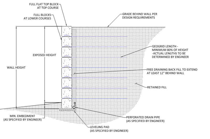

MSE is basically a wall tied with Geogrid. If the courses are the same, you can tie the two walls together by laying a grid over. Given your heights, the forces do not seem large. I could be misunderstanding the problem however.
Brad805, are you talking about tying the retaining wall and the planter walls together? The issue in the OP is global sliding of the combined walls since they share a footing (retaining wall and planter wall). I don't think your suggestion of tying the 2 walls together is relevant.
Aren't you required to do a more in depth global stability analysis for MSE walls?
Aseur, I meant in general terms. We get a geotech or supplier engineer to design the grid.
gte, yes, the idea I had is sketched below.
