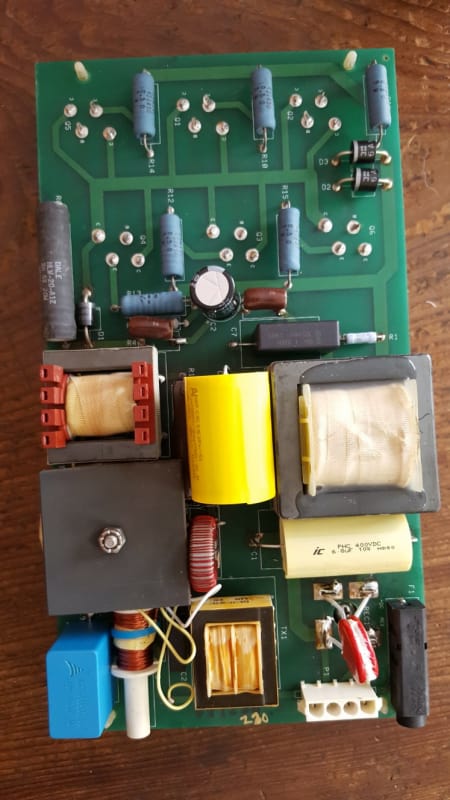

I have 5 high power ultrasonic driver boards in front of me. Sadly 4 of them have one of their 6 paralleled BJTs blown. They have crazy specs and seem to have been obsoleted by ON Semi around 2K.
They are MJ16018.
They were replaced by Semiconductor Technology's ST16018 also gone now.
They had crazy high voltage specs.
V[sub]CEV[/sub] of 1,500V !!! I can't find a BJT in T0-3 over 750V in Digikey.
I know some of you have crazy web foo and may be able to churn something up. I've spent about 2 hours on it with nothing to show.

Same problem I'm having. None of those will work in a TO-3 setup with massive machined heatsinks, with plug-in, screw-down, thru-the-back of the assembly setup.

Have you looked at conversion to IGBT switches if the BJT solution doesn't work out? A couple of IGBT packages could replace that paralleled BJT setup quite easily and probably retain the existing heatsinks. You'd need to do some tweaking to the drive circuit but there should be ample drive capability. What is the circuit config - a half-bridge driving a transformer?

Thanks IR I think one of those NTEs would maybe work if I replaced all the MJ16018s so they shared better.
VE1BLL, Scotty; You both found the same herd of poke-a-dot unicorns on opposite sides of the pond. I don't have to hope an oddball plays well with the existing other 5 on each repaired board. I'll gladly pay $20 bucks a piece. Well, my customer will, as these boards are irreplaceable. I've picked similar spec'd caps seen on the board below to replace the originals that now each cost $25+ with a minimum of 25 and 50 pcs with 19 week lead times... I'm hoping my subs fly. I gave the customer two 'repaired' boards today and will await his trying them before proceeding with repairing the remaining 3 boards plus cycling thru the four boards he still has running that are all likely about to age-out croak too. The machine is supposed to have eight of these but they're down to only four.
And that MJ16018 you found Scotty is not close - it's exact.
As usual I have no schematic for this thing.
Note the six TO-3 on the back at the top.
Scotty this thing takes in 120Vac and puts out the ultrasonic drive all thru the one Molex at the bottom. Why it needs six freaken transformers/inductors is beyond me. Why not just make a free running oscillator, boost it a few times and feed it to the transducer?
Oh and what's with the RTVed together MOVs at the bottom? (Across a typical bridge rectifier)
