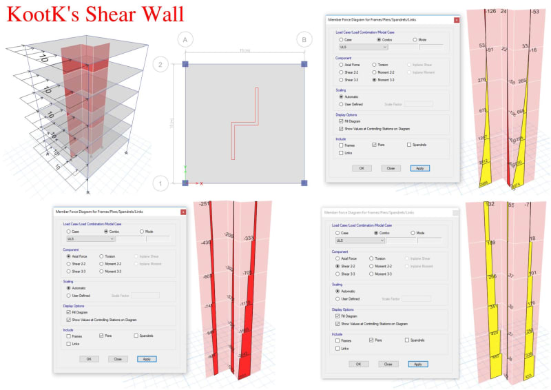

1) The sketch below shows another, interesting area of concern for me. A classic column design approach wouldn't pick up the in plane moment in that central wall segment.
2) An appropriate ETABS model would pick up the in plane moment in the central wall segment.
3) In many buildings, this moment would be restrained by the diaphragms and transferred to other lateral elements within the building. However:
a) this path has meaningful flexibility associated with it which will reduce the efficiency with which shear is transferred between the tension reinforcing and the compression block. In conventional column design, this shear transfer mechanism is assumed to be infinite.
b) this approach requires one to design all of the lateral elements in concert rather than designing one at a time in isolation.
4) Through the course of this discussion, I've come to realize that, for me, there are two distinct classifications of shear wall:
a) Walls for which the shear web is a single, planar wall regardless of the presence of flange walls. Most of the compound wall research is geared towards this kind of wall.
b) Walls for which the shear web is comprised of multiple segments that are not co-planar. Accordion webs. This condition concerns me much more and has been studied much less.

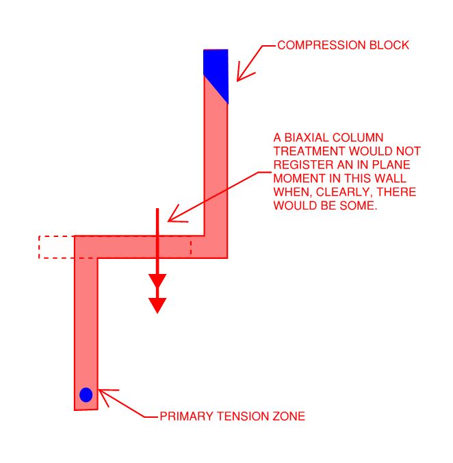

How would a strain compatibility approach not register an in plane moment in that section, assuming there is reinforcement distributed across the area?
As long as that area has bars, if you pulled that section out in isolation the variation in reinforcement strains and in turn forces would absolutely yield a non-zero moment over the segment.
We'll have to be careful with our language here. Some versions of a strain compatibility approach would capture that moment. It is my proposition here that a strain compatibility approach as normally applied in biaxial column design procedures would not. That, because:
1) Such procedures give no explicit consideration to the shear path connecting the flexural tension reinforcement to the compression block.
2) Such procedures do not involve isolating that section as you proposed in your statement below. That exercise would be something in addition to the normal column biaxial procedures.
It would indeed yield a non-zero moment. Unfornately, that would be the wrong moment because the vertical reinforcing outside of the wall segment also contributes to the in plane moment within the wall segment.
I'm not following that last image, KootK. With the moment you are showing, the entire left side would be in compression and the entire right side would be in tension.
The moment that I was showing symbolically was not the primary moment applied to the wall assembly as a whole. Rather, it was the moment induced in just that central wall segment when the entire wall group when a strong axis moment would be applied to the entire wall group.

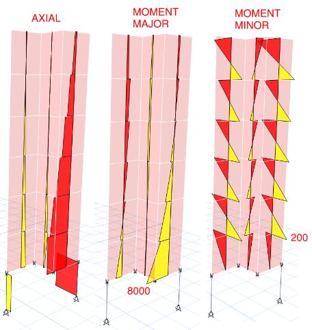

KootK,
I whipped up a little test to demonstrate the relative magnitude of that in-plane moment generated on the perpendicular wall.
This effect would be captured if we design compound wall assemblies as separate individual piers, as many I've seen many engineers do so.

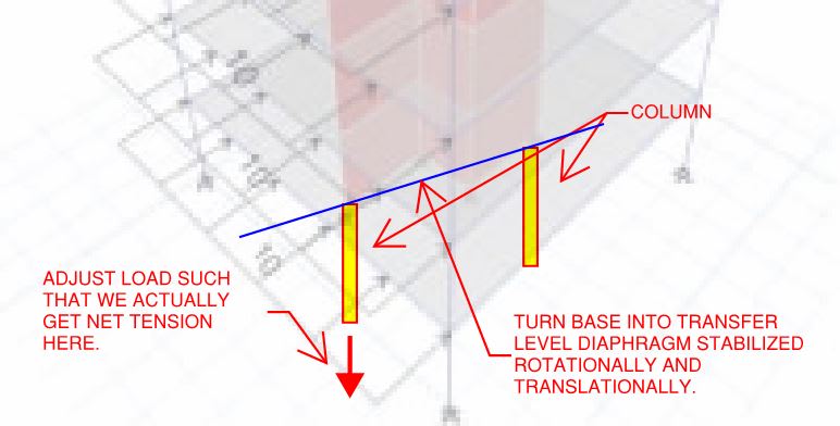

Sort of. That analysis would capture a version of this but it would be tainted by ETABS's treating the walls as linear elastic as opposed to the plastic design assumptions typical of biaxial column designs. Would you have time to re-run it as shown below to force more compatible behavior?
That seemed to reduce the major moments in the middle wall slightly and then also reverse the moment on the tension wall ...
Looks like that doesn't play so nice with the gravity loads.
